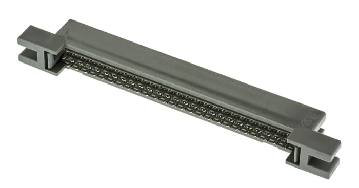

3M 4600
4650-6000 3M | 3M, 4600, 50 Way, 2 Row, Right Angle IDC Connector | 121-0371 | RS Components
My suspicion, this was a typo...

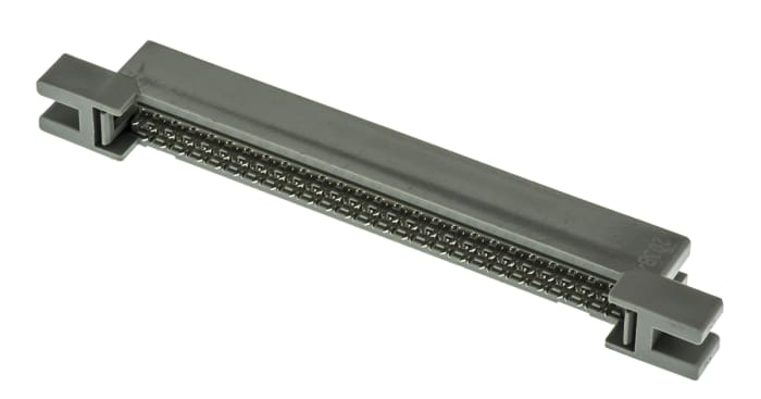

Yes typo… 3M 4200 is what I was meaning to say. It’s not nearly as permanent as the 5200 and it hold good, but can still be removed. It’s not like silicone in it smell or feel. I have used it to seal the holes in Lilly and it works a charm.
