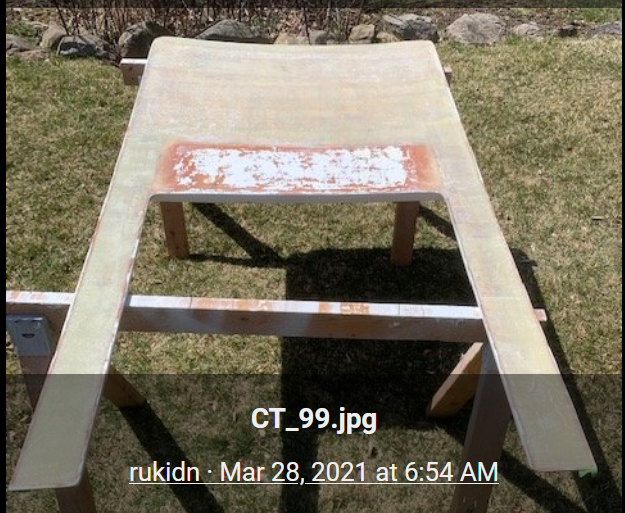

A while back I posted the rebuild of our companionway hatch cover. Moisture damage. Now I need to reinstall and caulk the seams. After reviewing so much online information, I remain confused as to the best choice to caulk these seams. Not 5200, other 3M sealants yellow, some chalk like Lifecalk. What have you use with success? Tools easily, stays white and clean, isn’t permanent, etc.

I know my monitor grows blurrier as I get older, but I don't see where these seams are in what appears to be a solid piece of plywood.
Is the cabin top to be painted or ........................... ?

You’re looking at the bottom in the photo. I opened and replaced the balsa core due to extreme moisture. Top is white gel coat edges and gray nonskid. Covers companionway sliding hatch. Seam in question is between this part and the cabin top itself.

I was having a difficult time visualizing “the seam”. Do you mean the cut line you used to open up the panel and remove/replace the rotted balsa?
If so then you need to be using epoxy and fiberglass cloth. You need to adhere the fiberglass to the balsa so that the skin and balsa are one solid piece. Not doing it leaves a void. You will know the void exists when you step on it. It will eventually crack the fiberglass.
When the piece is solid you’ll be filling the seam with thickened epoxy. I might think about using Thiox. Easy to apply along a seam line.
Depending on the space I would add some strips of cloth and resin overlapping the seam to reduce the chance of water getting in there.

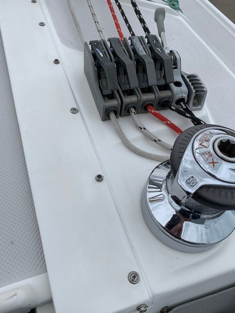

I've heard this piece referred to as a "sea hood" or "spray hood" it fits over the area of the companionway slide when it is opened. There is a seam about 1/4" between it and the surrounding deck which is caulked with something at the factory when built. I think butyl would be good for the bottom edge but something still required to caulk above it.

Found some photos on the 320 org site that show the area but I couldn't find any reference to what he was using for caulk.
Seahood
Yes, this finished seam between hood and cabin top. Factory caulk essentially gave it up years ago.
