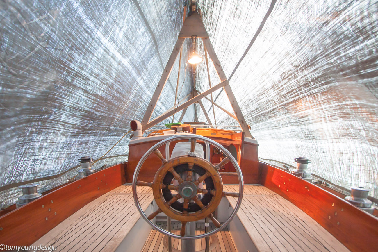

My daughter helped me put the cover on yesterday, and it looks just like this in the off season (this was taken in 2020): All hatches open, air moving through, rain and snow kept out. But I live just a short walk from the boat so I can keep an eye on the cover and frame.

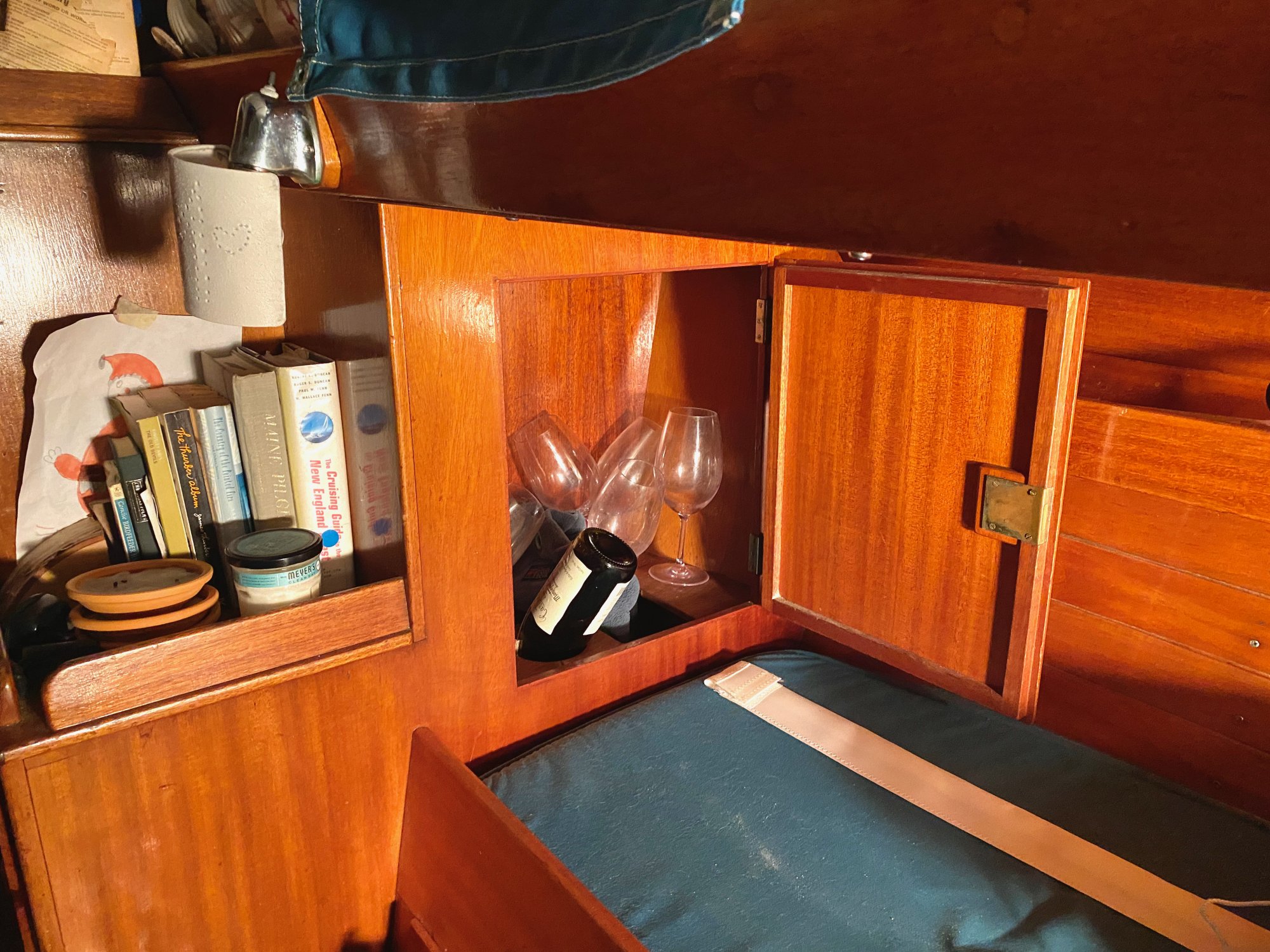

We do some things backwards, I was thinking today. I was headed to the newly covered boat when my partner handed me a pile of clean bath towels, dishtowels and a 60's vintage plastic bowl. "Could you put these back on the boat if you're going down".
We're often doing that; bringing stuff to the boat in the fall. Most everything stays on board over the winter as it's nice, dry storage. Except for the sails and most perishables, it stays onboard. Batteries fully charged and turned off, engine winterized but raw water hose re-connected, oil and filter changed, it's ready to go into the water again (after spring tasks), including nearly everything we need except food and clothing.
Oh and then she stopped me to say, "There is a good bottle of red wine in the wine locker. Don't forget that".
I'm glad she told me that. I'd rather see a church burn than to find that wine label sitting on a pile of glass in the spring.
Now that's the right attitude! ;)

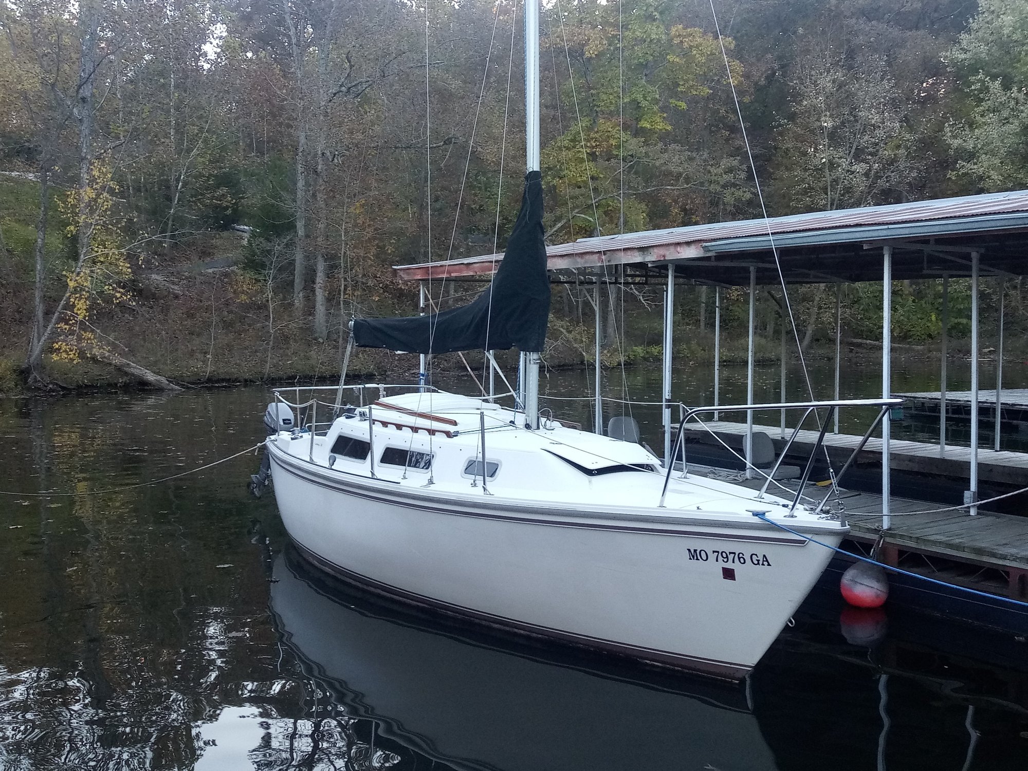

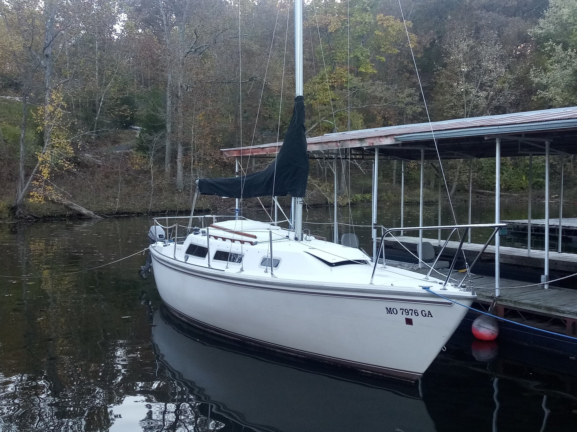

In the water and ready to go other than the head sea cock is closed and the head is flushed with pink antifreeze.
I winterize 400+ power boats a year. The joys if year round sailing appeal to me more than speed and petrol.
