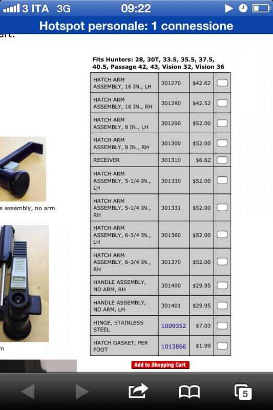

Gasket (seal), arms and receivers are here:
http://shop.hunterowners.com/hp/viplex.php
Unfortunately, I'd be shocked if that trim is still in production.

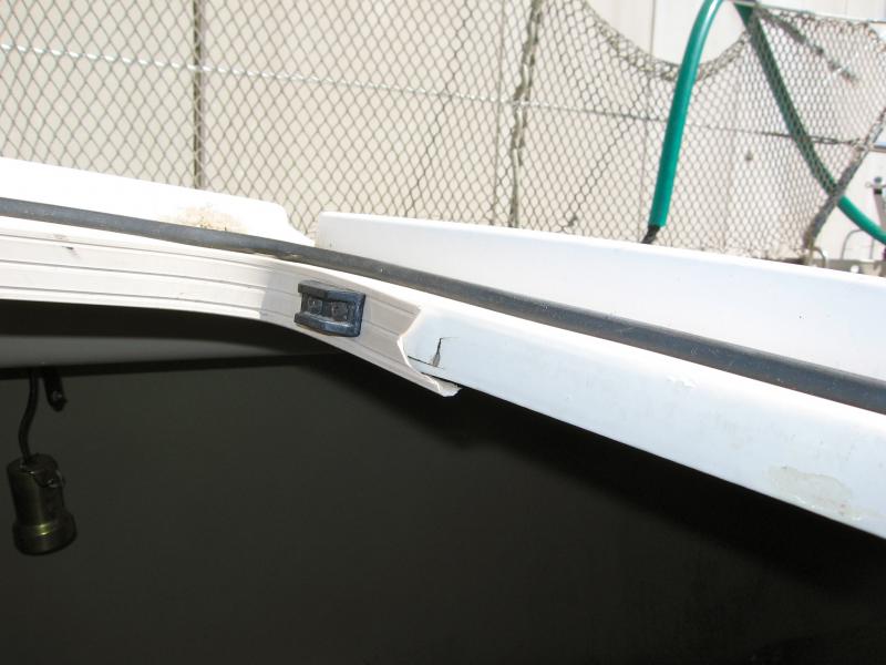

Last question on this topic, the seal of white plastic, and this, gasket for foot code 1013866, in the last position in the table, excuse me if I ask explicitly, but the translation into Italian can understand another, thanks for the help that you give me !!!!!IMG_2824.jpg
Dec 14, 2003
1,433
Where can I buy this seal of white plastic? thanks
It is not a seal. The seal is above it on the ledge where the hatch sits. It is only a trimming to hide the edge of the fibreglass where it comes down. It is very doubtful that you can still find the exact plastic trimming. I would remove the rest of it around the hatch and fabricate a nice one with teak. It can be glued to the fibreglass of even screwed in. Good luck.

Thanks for the suggestion, i would do the same, I try to make it of wood, and then i'll send a photo, thanks ciao to soon
