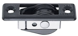

Apparently most hunters of the "below deck furler" era had problems with moisture getting into the core due to lack of sealing the core for the thru-deck holes. Mine too. Some later owner sealed up the exposed core already.
I do have a pair of harken thru-deck ball-bearing leads:
That I plan on installing them in combination with some better blocks in the anchor locker to help it all run smoother (if I keep the furler). The current thru-deck guide plates, while polished SS, add a lot of friction when under load.
