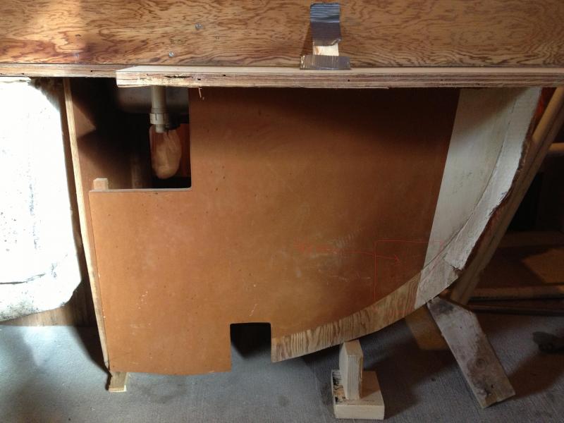

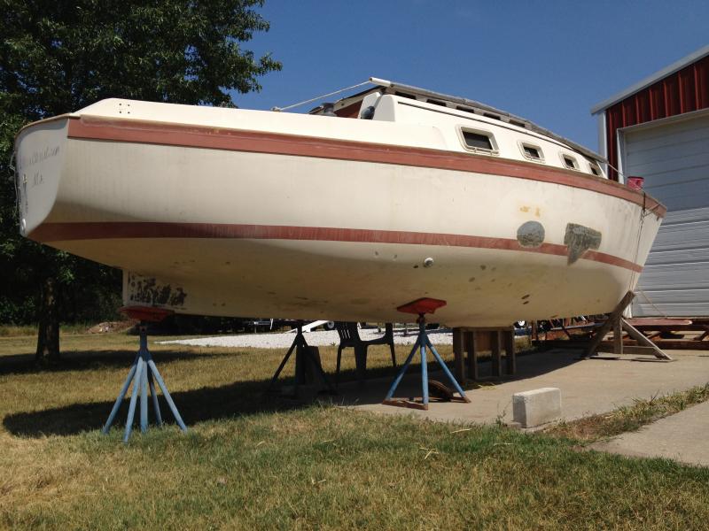

I am rebuilding a Katrina damaged H25 I bought. The thru-hull drain for the galley sink was located below the water line with no sea-cock and no access except to reach at arms length through the tiny galley cabinet door. A bad hose or connection here will sink you!
I have viewed pictures here and on other sites which seem to indicate some boats have this thru-hull above the waterline while others are below the waterline. Friends beware. In my case I am replacing the entire interior and have new bronze sea-cocks already in hand. I'll cut an access panel in my new aft bulkhead of the galley cabinets to access the sea-cock from the cockpit locker. Perhaps others should consider the same.

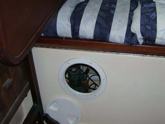

the 33 galley sink drain has a sea-cock but like your boat no easy access to it. The access is under the port seat that requires moving the table, cushions, and foldout for cabin bed to get to it, lol. The only reasonable answer is an access cut out. Just do it.
