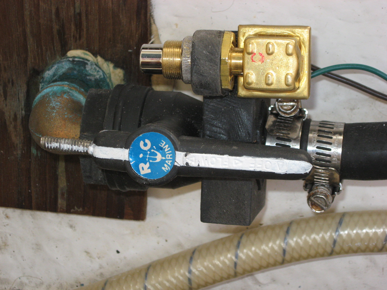

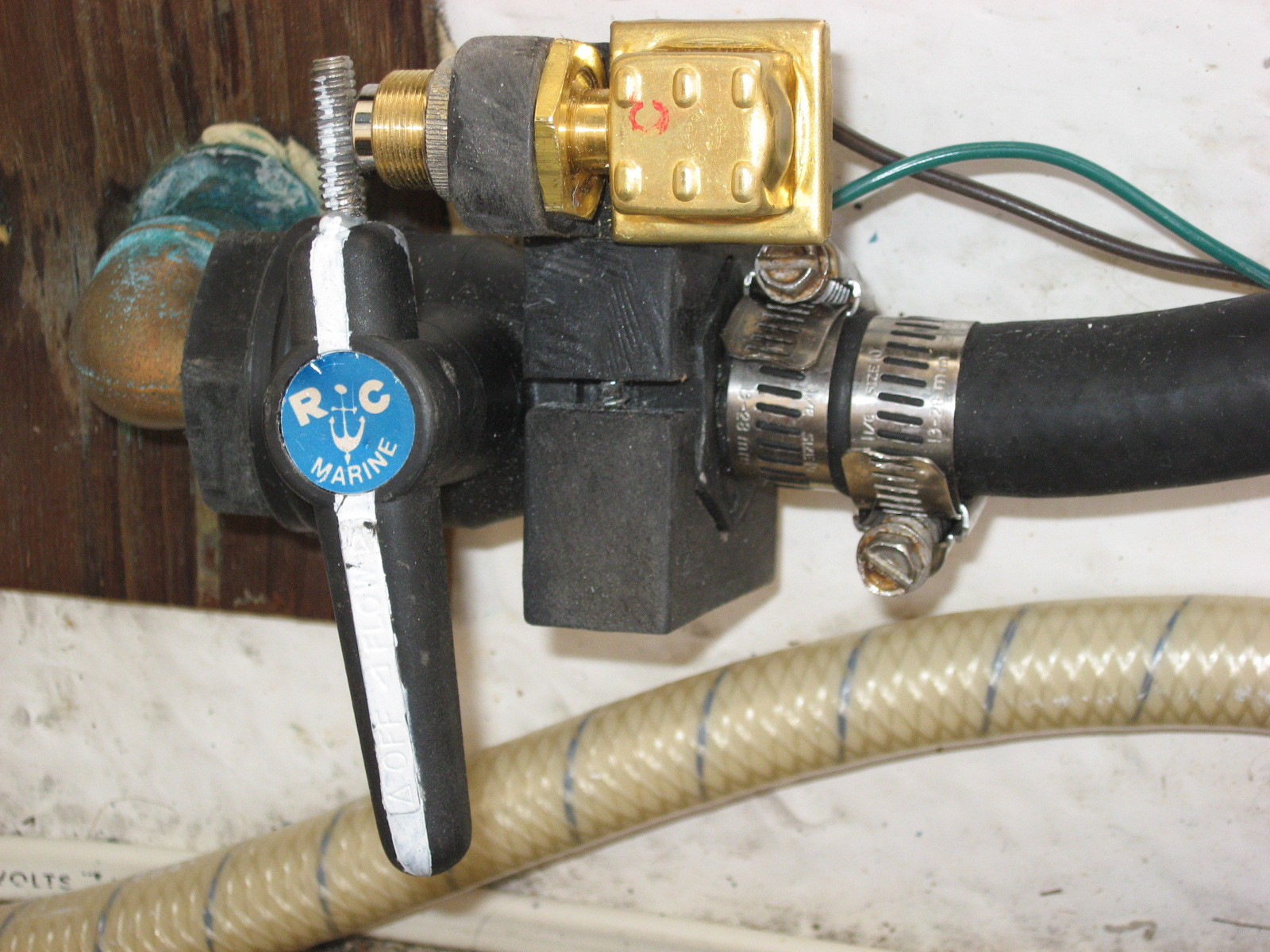

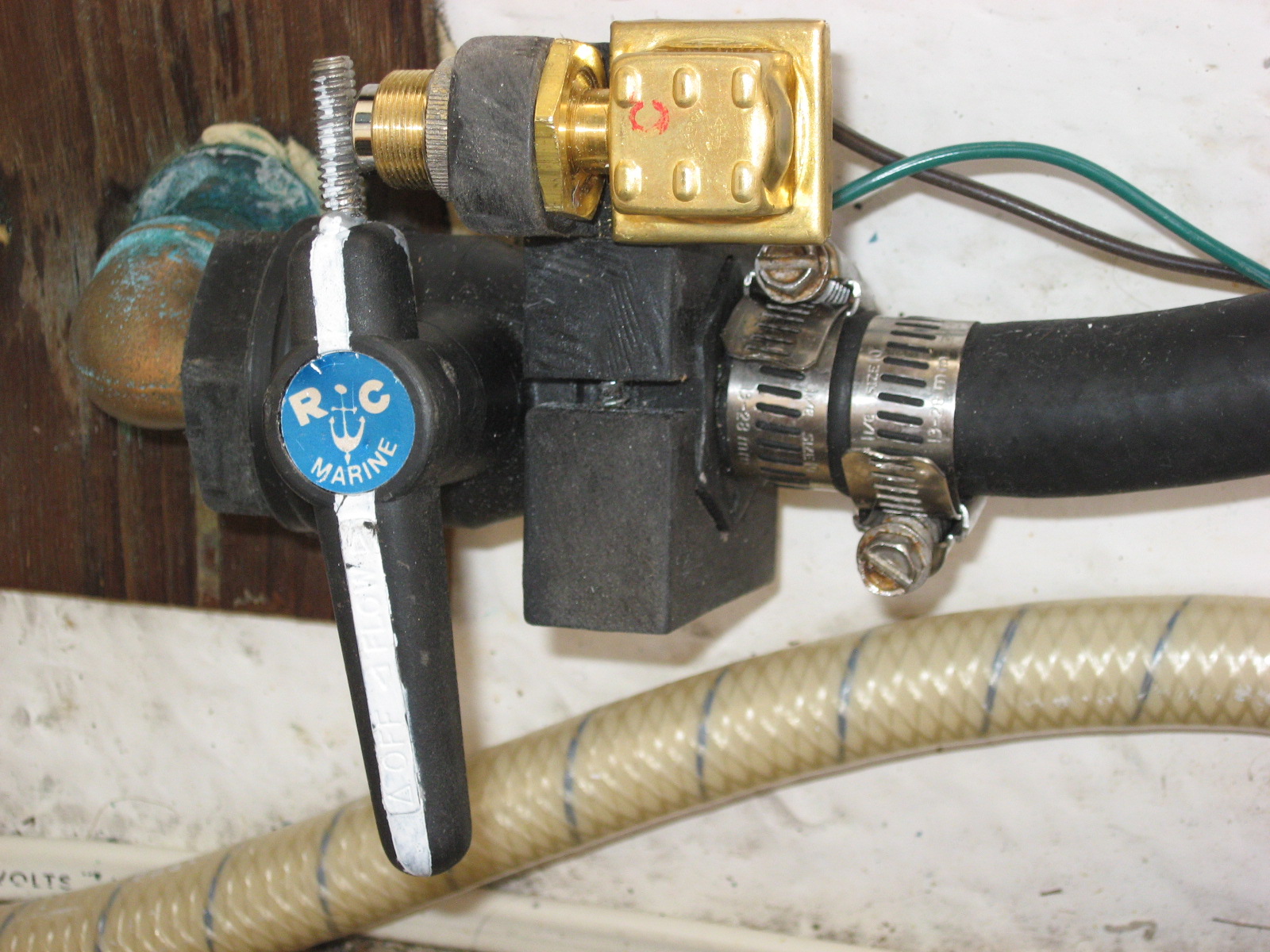

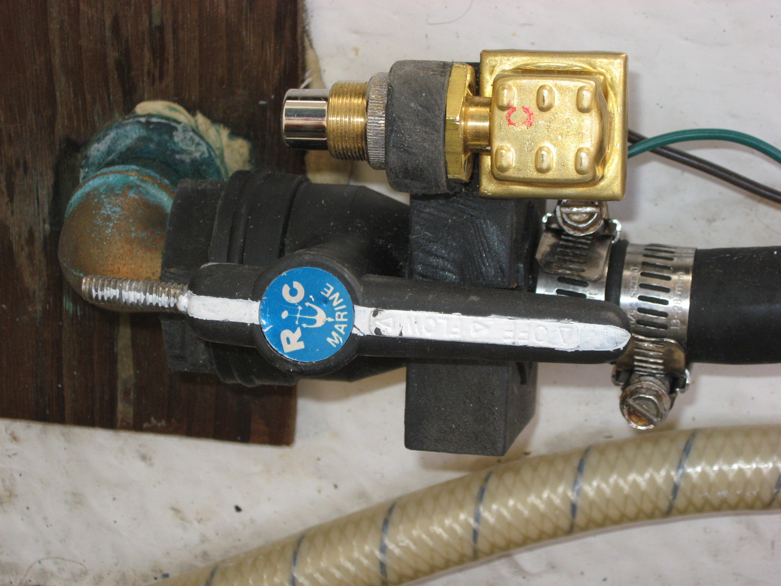

Distracted by guests once and having over-nighted at a guest berth, my normal seacock opening routine was disrupted. 10 minutes up the channel, the engine started to overheat. The impeller had run dry and self destructed. Fortunately, all did end well that day. A light wind and one crew member who could sail with just the jib up gave me the chance to remove the raw water pump and replace the impeller.

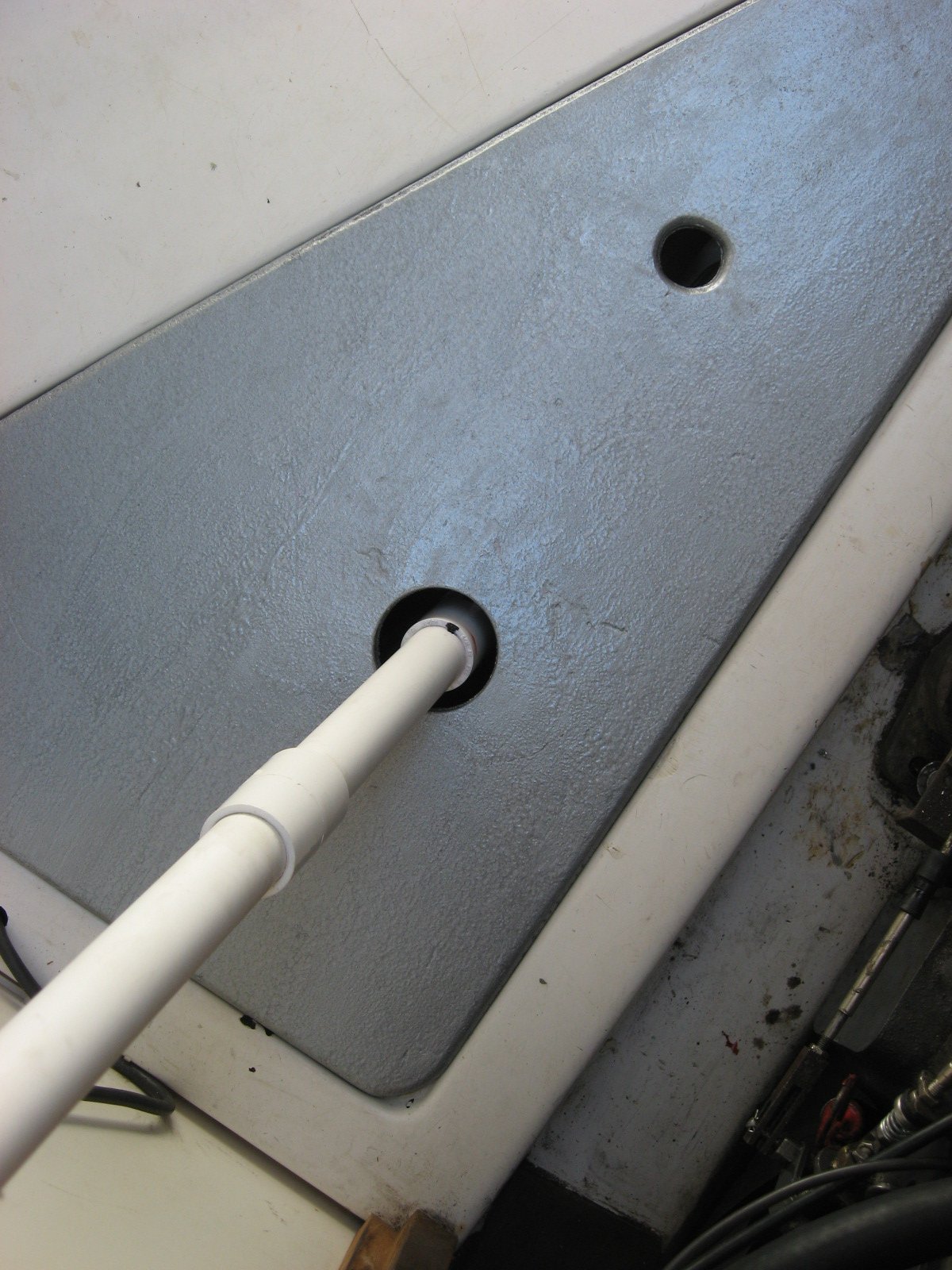

Vowing never to have that happen again, I cobbled together a "closed seacock" audible alarm. When starting the engine, if the engine alarm doesn't stop after a few seconds (when the oil pressure is OK), then I know the seacock is in the closed position. Picture of the setup attached.

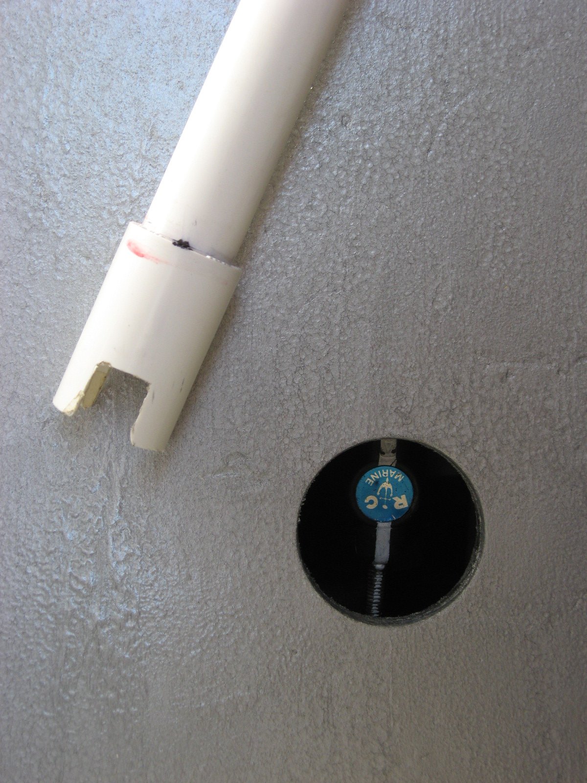

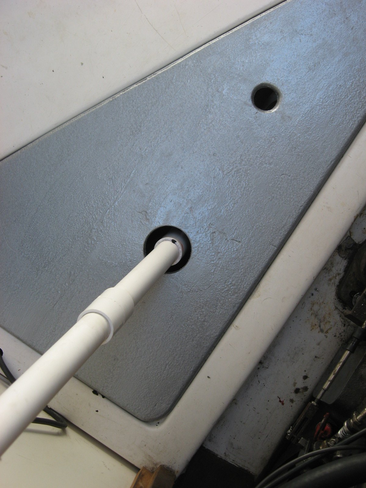

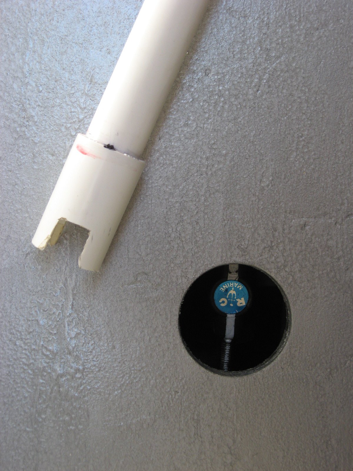

Stretching myself over the lazerette seat coming to reach the seacock was difficult and very uncomfortable. Using PVC pipe, I made an extension. On the top of the extension is a PVC T-fitting which acts as the handle. Now no problem to open and close in comfort.

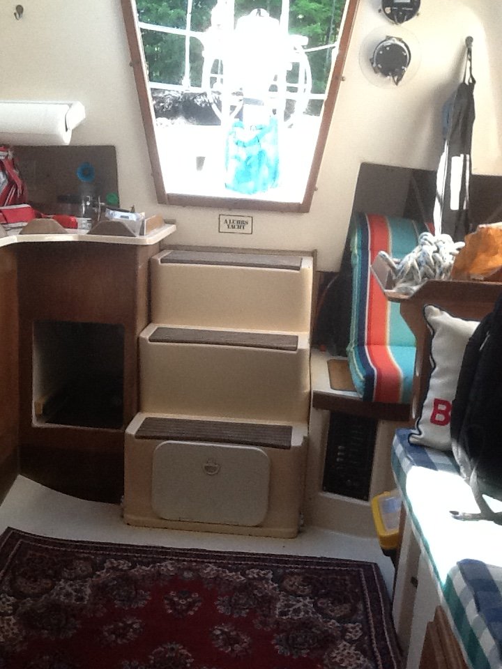

The Engine manual says to close the Engine Seacock after sailing, and open it before sailing. Is this necessary? Access to my Engine is not the easiest thing...

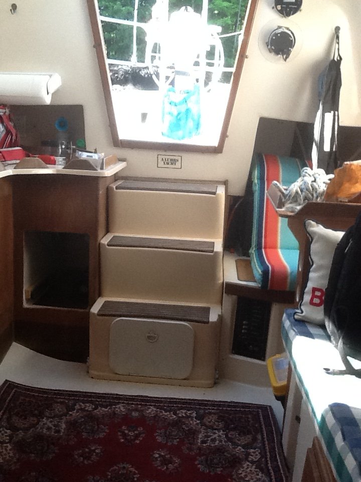

I installed a hatch in my stairway to make access much easier. Not the prettiest thing, but very functional.
