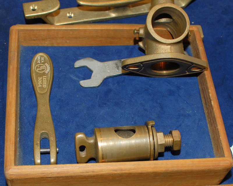

Gawd yes!! Some high end builders actually still use them. Spartan Bronze (Cape Dory) & Blakes still makes them and they last forever if maintained. I have seen 30+ year old tapered cone valves still going strong. Like anything if you don't maintain them you kill them..
Spartan Tapered Cone Seacock
