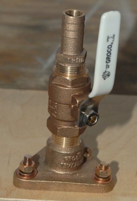

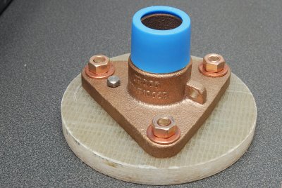

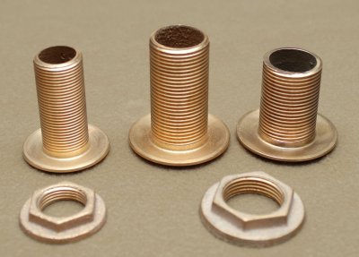

In my opinion as long as they are properly done there is nothing wrong with
through hulls. Most boats have 6 or 7. Properly means a flanged seacock or
through hull with a quality ball valve and fiberglass backing plates epoxied
to the hull. I think that your plan with the diverter valves creates a
riskier situation as you will have more connections in the boat. Here are
links to the best way to install seacocks and through hulls.
