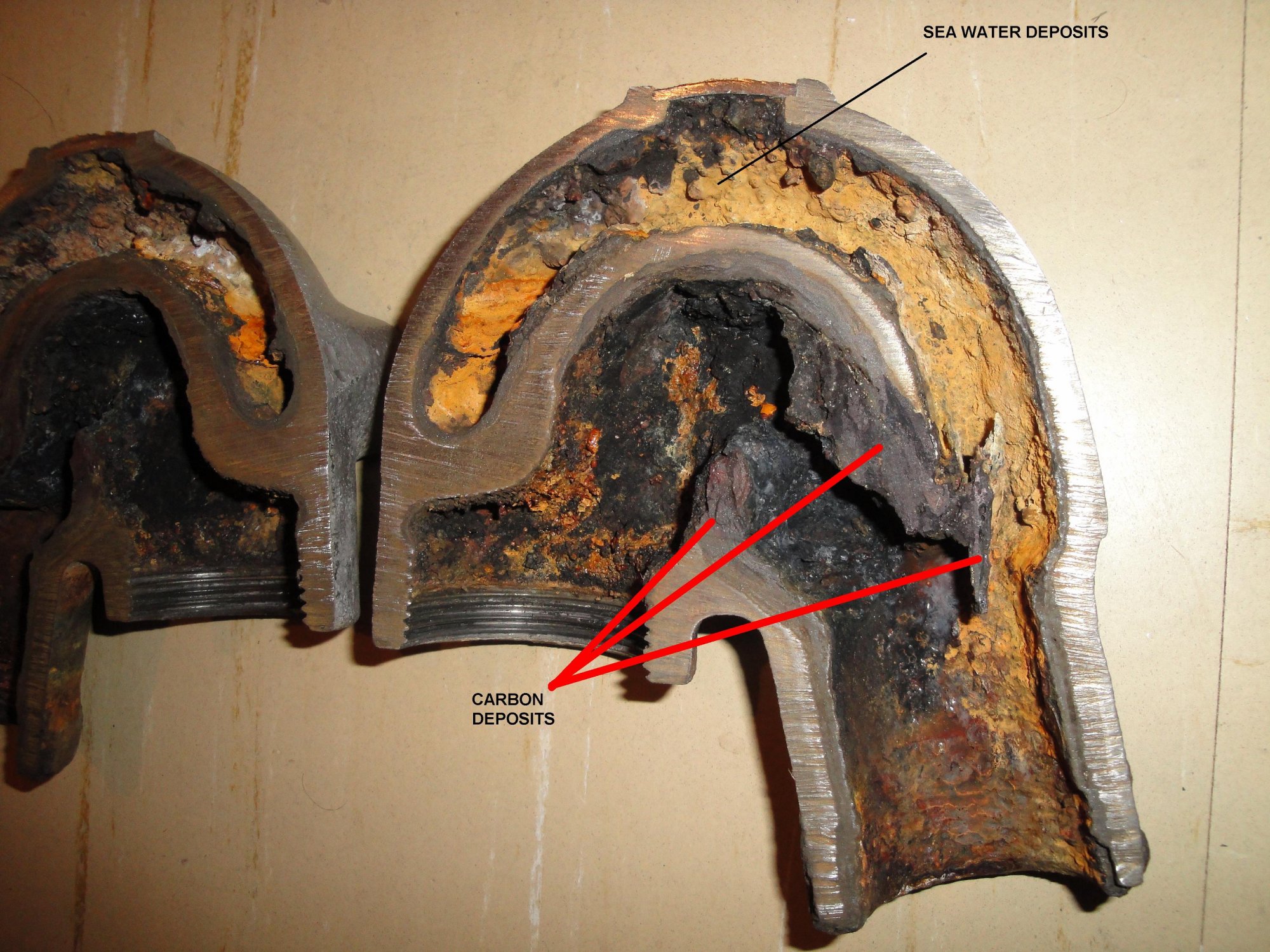

The easiest method would be to work backwards from where the sea water enters the mixing elbow. Disconnect the hose and get someone to crank the engine and see what comes out. Nothing ? keep going back towards the pump until you find the blockage.
Maybe you have one of these ....................

Thanks for all your input! Through trial and error I found it. It happened to be the mixing elbow clogged, relatively easy fix. Thanks for all your insight and advice. Made it much easier to get to the bottom of this!
