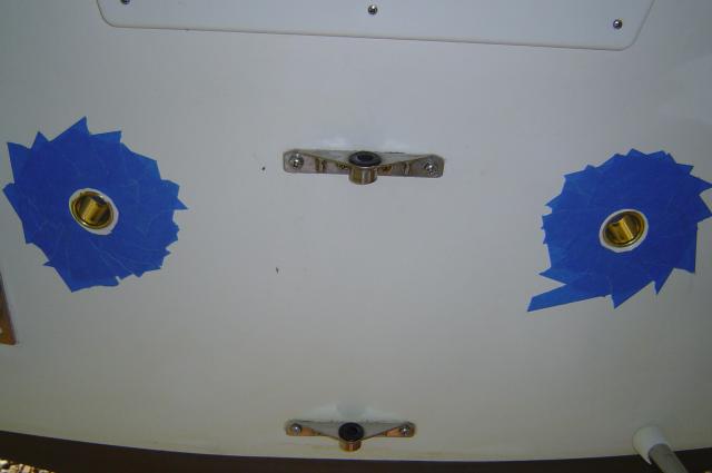

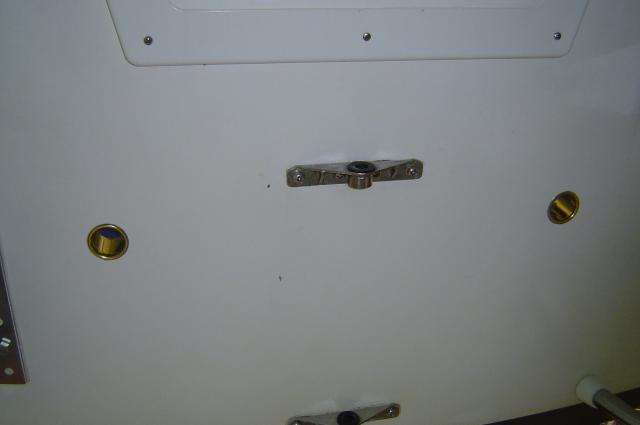

This is an easy addition I bought a tool that allowed me to install the 1 1/4" tubes when I added them to Lat Penny. Tool was 35.00 tubes were 3.50 a piece. Hardy any of the boats are the same between the liner and hull Last Penny was no exception 1/4" on one side 3/8" on the other. Once the area is filled it's just a matter of drilling the hole and installing the tube.

I had to replace the scuppers on my Capri 22 last year. They're the same size as the C22 kit from Catalina Direct. The kit came with everything necessary to do the installation including plywood to reinforce the transom, a hole saw, and the tool to crimp the edges of the brass scupper. The instructions seem fairly straight forward and easy to follow. You have to return the saw and crimping tool within 2 weeks (I think) or pay a substantial fine.

If you order the kit from Catalina Direct it will come with the flange tool.
