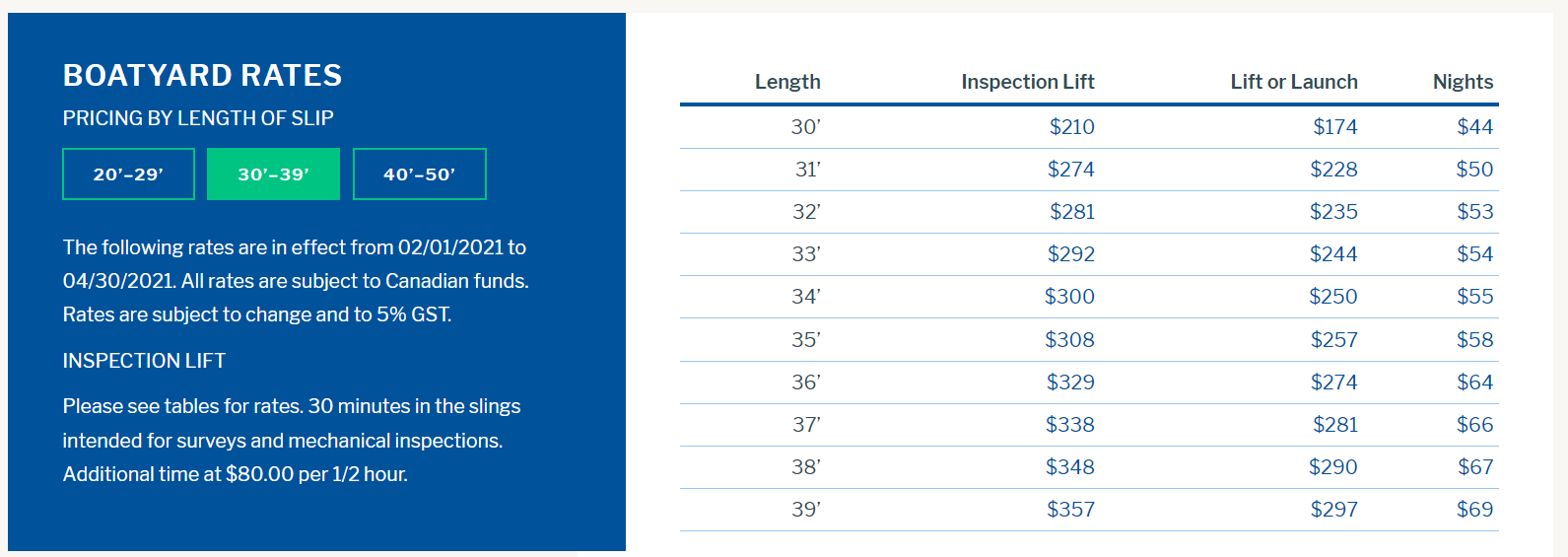

Man if you open the border I’m bringing my boat up to haul, spay the bottom and inspection.
OMG o_O ..................... sorry if I made you spill your afternoon coffee but that $100 dollars was in addition to the half haul out charge. If you want to scrub-a-dub-dub by yourself in the water, you can save the $100.00.
So all in for a half haul and pressure wash is ($274 + $100) = $374 for me.
For you ($308 + $133) = $441
C'mon, American exchange and a few other bonuses thrown in, how can you go wrong ? I'll even meet up with you and from there we can go to Snug Cove on Bowen Island and really get hammered without anyone knowing who we are. Everyone over there knows @Meriachee from previous incidents so he can't come along.
