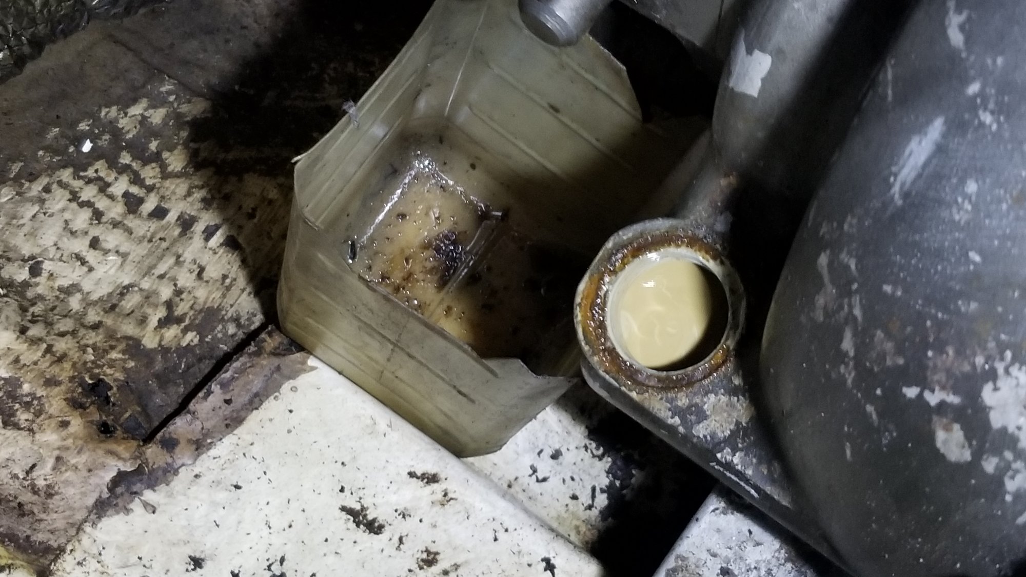

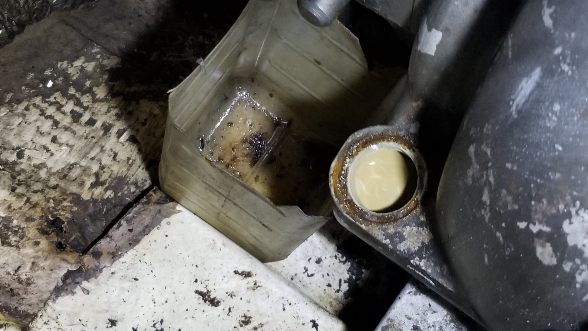

Went to change trans fluid today in this new to me hunter 27 and oil was completely filled to brim with emulsified oil. way over the .5 liters than manual states. There was a fresh water flood while the boat was dry docked according to previous owner. So I assume water got in from that but from the oil fill screw cap? The transmission isn't fresh water cooled is it? So far I pumped emulsified oil out it's super thick sludge. Should I flush with anything particular or just do a few oil changes? Any input would be great.
10,093
mayonnaise..
It is not water cooled nor or there water connections on the gearbox. Water must have been at or a little above the shaft and it leaked in through the shaft seal. Ya probably OK if ya do a couple of changes but feel/look for a low point drain so you can drain the sump .. If you want to flush it, get some Marvel Mystery Oil and put a liter or a bit less in and run the engine but don't put it in gear.. That will stir everything without loading the bearings.. One flush and one change with the correct oil should do it.. monitor the oil condition for the next few hours of loaded run time.. Good luck with it

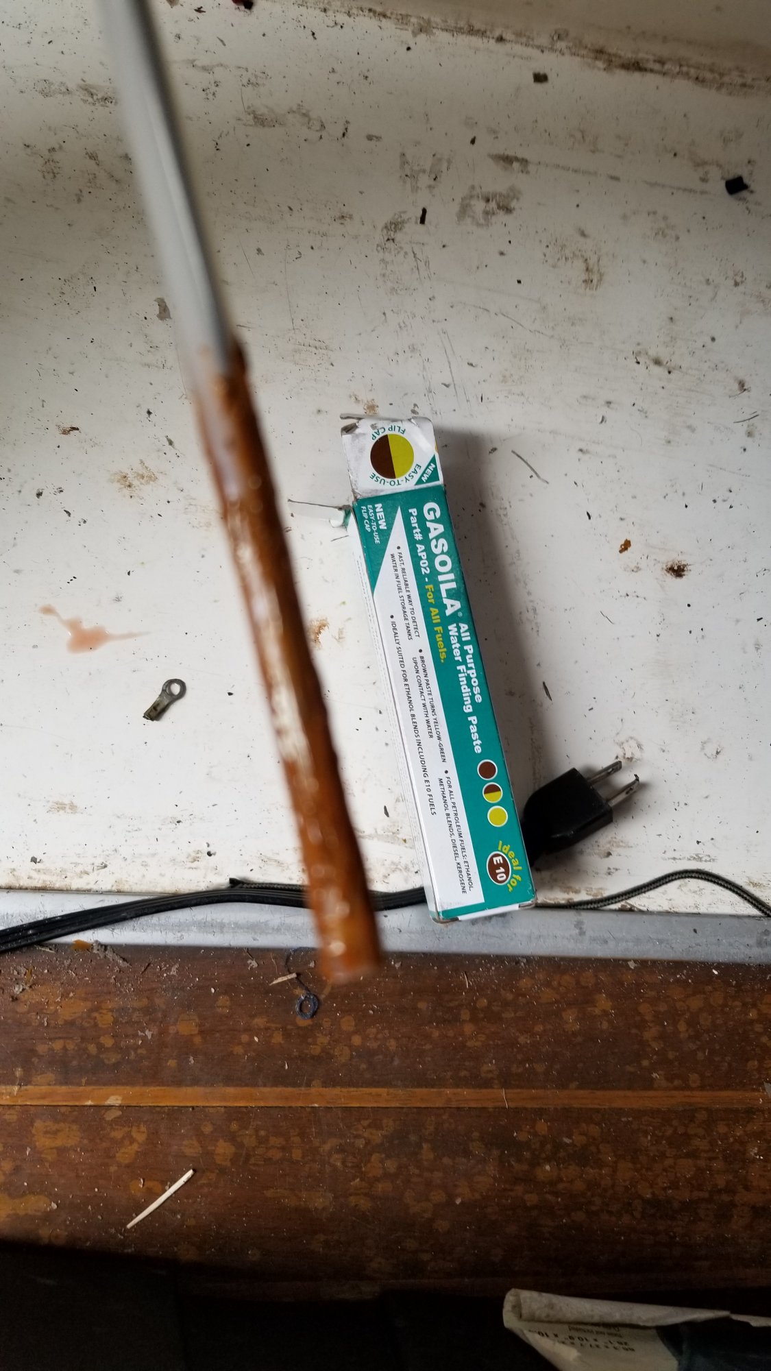

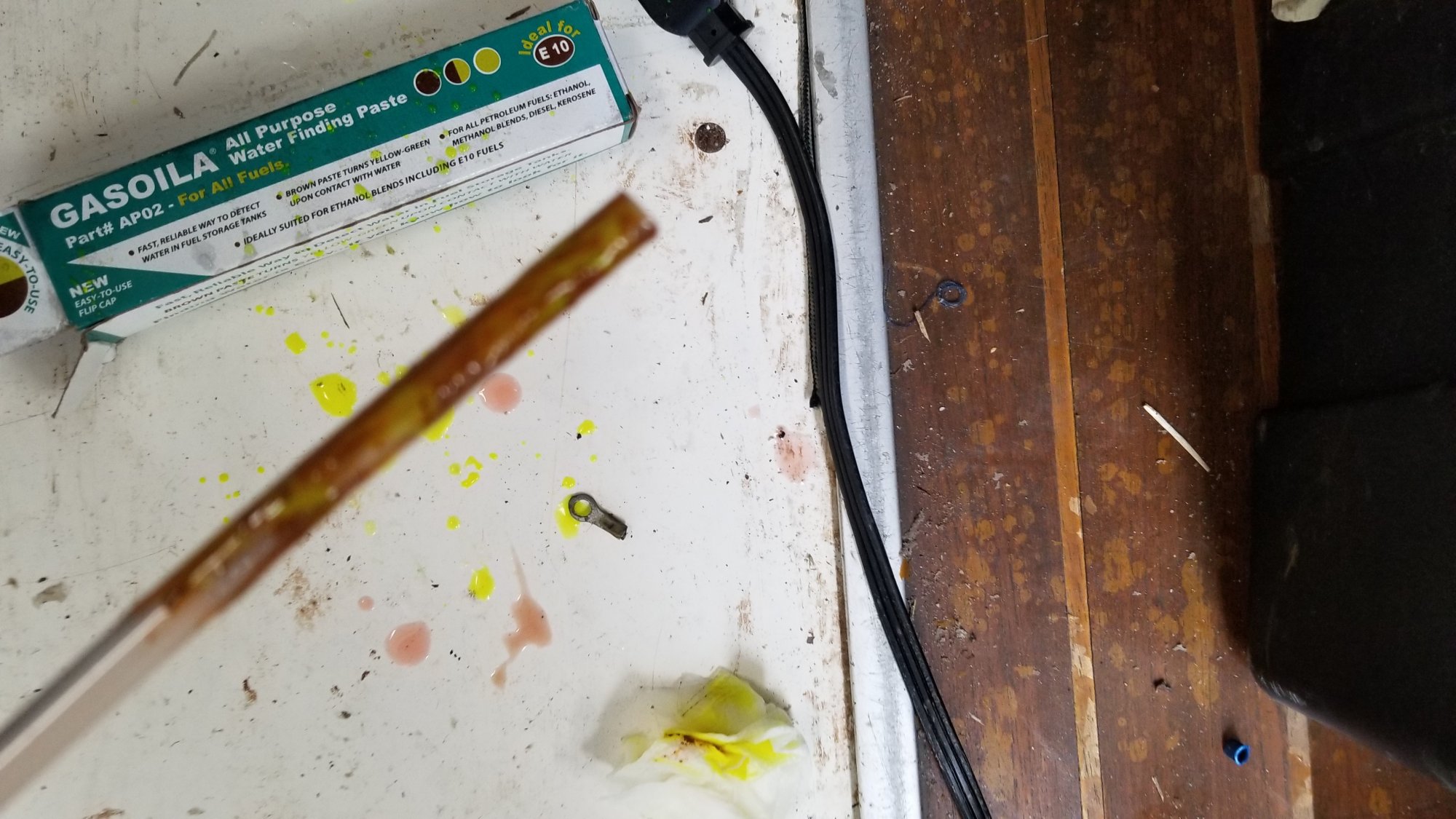

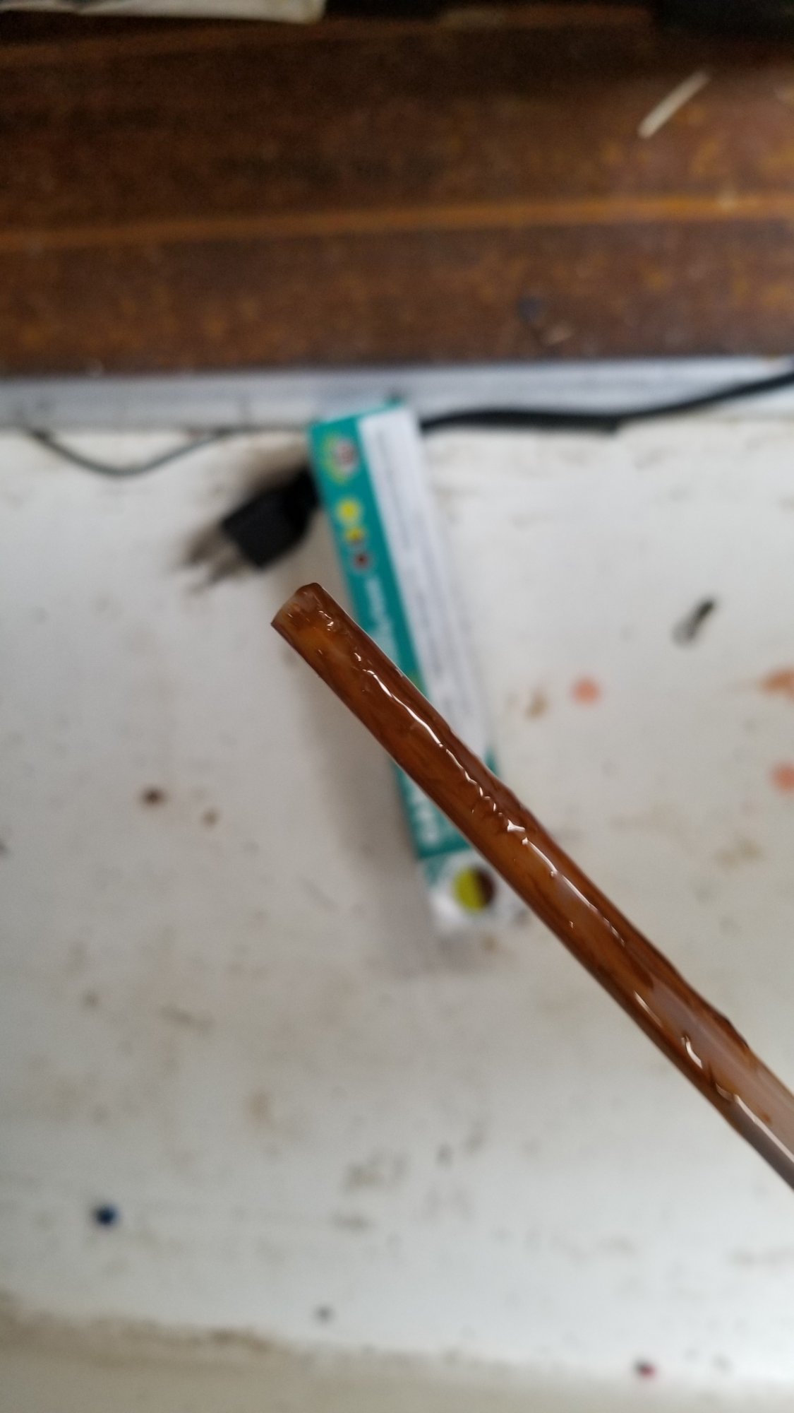

I soaked with marvel extracted about liter of marvel out of the bottom of the trans resvoir and did a stick test with gasoila a water finding paste in the reservoir and didn't get any color change. I then tested a control sample of oil with water and got color. looks like marvel worked thanks Kloudie I am going to soak until tomorrow and then pump and refill with oil and monitor for water.

The dipstick/fill cap has a vent hole in it. If that was underwater, likely that's how the water got in. Hopefully it wasn't in there long enough to cause corrosion damage, and a couple oil changes should fix it.
