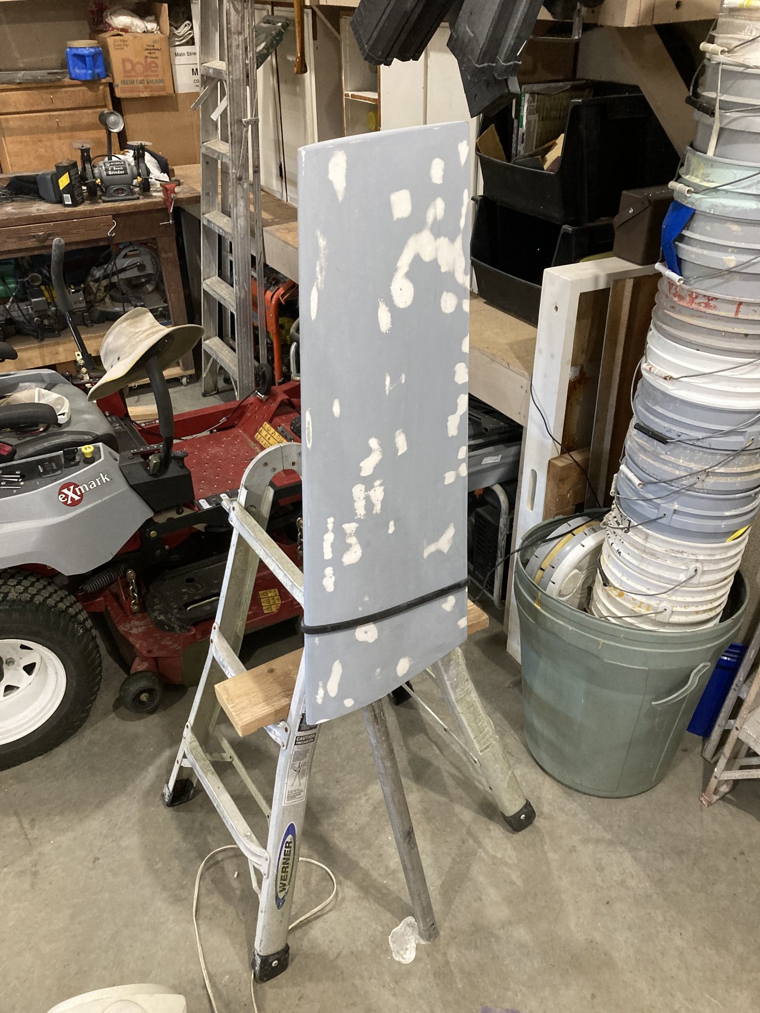

1982 Merit 25 rudder is saturated due to a very difficult-to-seal joint where the stainless steel rudder shaft (tube) enters the top of the restored and finished wood-core (Balsa?) rudder body that was re-fiberglassed 5 years ago at a body shop that services many boats. This is the first haul-out, and trailer to home since I launched her 5 years ago, and she has been a great day sailer and racer, and has been kept at Lighthouse Landing (marina) on Kentucky Lake. Any tips on how to seal the stainless tube where it enters the top of the rudder would be greatly appreciated.

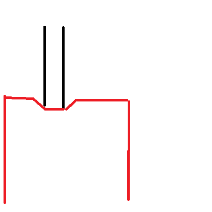

To seal the rudder shaft's entrance into the rudder, chisel/grind out the fiberglass around the opening to create a bevel, fill the bevel with 5200. Here's a cross-section view of the bevel (black is the rudder shaft, red the rudder):

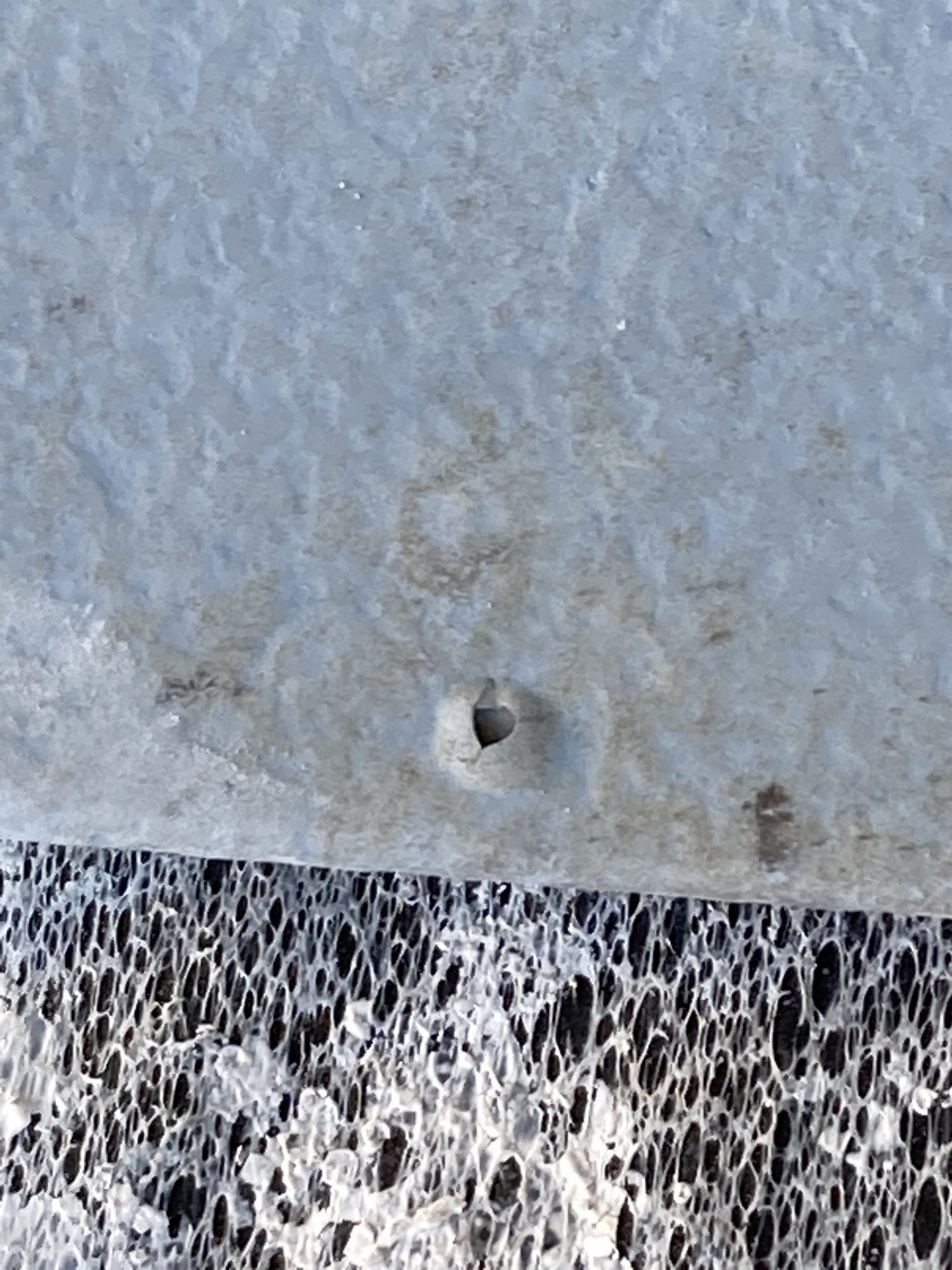

Your rudder interior is very likely hi-density foam. The SS post should have some sort of internal grid sometimes known in the trade as the "rakes" that either key into cross-drilled holes in the post or are welded to it.
You may have to take the rudder home and drill some drain holes in it, or also separate the two halves and replace (or totally dry out) the foam and them glass it back together.
This is correct, except for using 5200. The sealant needs to be flexible to accommodate the differential rates of expansion between the fiberglass and the SS rudder post. 5200 is an adhesive and is not flexible enough. 4200 or LifeCaulk (polysulfide) is a better choice. Both of these are quite flexible with good adhesion. Something like Silicone or 3000 will be very flexible, but will not have sufficient adhesion and may pull away from the post or the rudder.
Worked fine for me. Description of 5200 from the 3M site:
This high-performance polyurethane adhesive sealant becomes tack-free in 24-48 hours, and completely cures in 5-7 days with no shrinking. The seal is extremely strong, retaining its strength above or below the waterline. Stays flexible–allows for structural movement. Stress caused by shock, vibration, swelling or shrinking is effectively absorbed. Has excellent resistance to weathering and salt water.
13,960
I'm glad it worked for you. When I made a similar repair on my rudder I considered the rather extreme temperature swings, as much as 100°+ F, from -20 to 90+. A sealant that was more flexible seemed to be more appropriate. My concern about using 5200 in this application would be the stress on the fiberglass in the extreme conditions with an adhesive as strong as 5200. In a milder climate, this would be less of an issue.

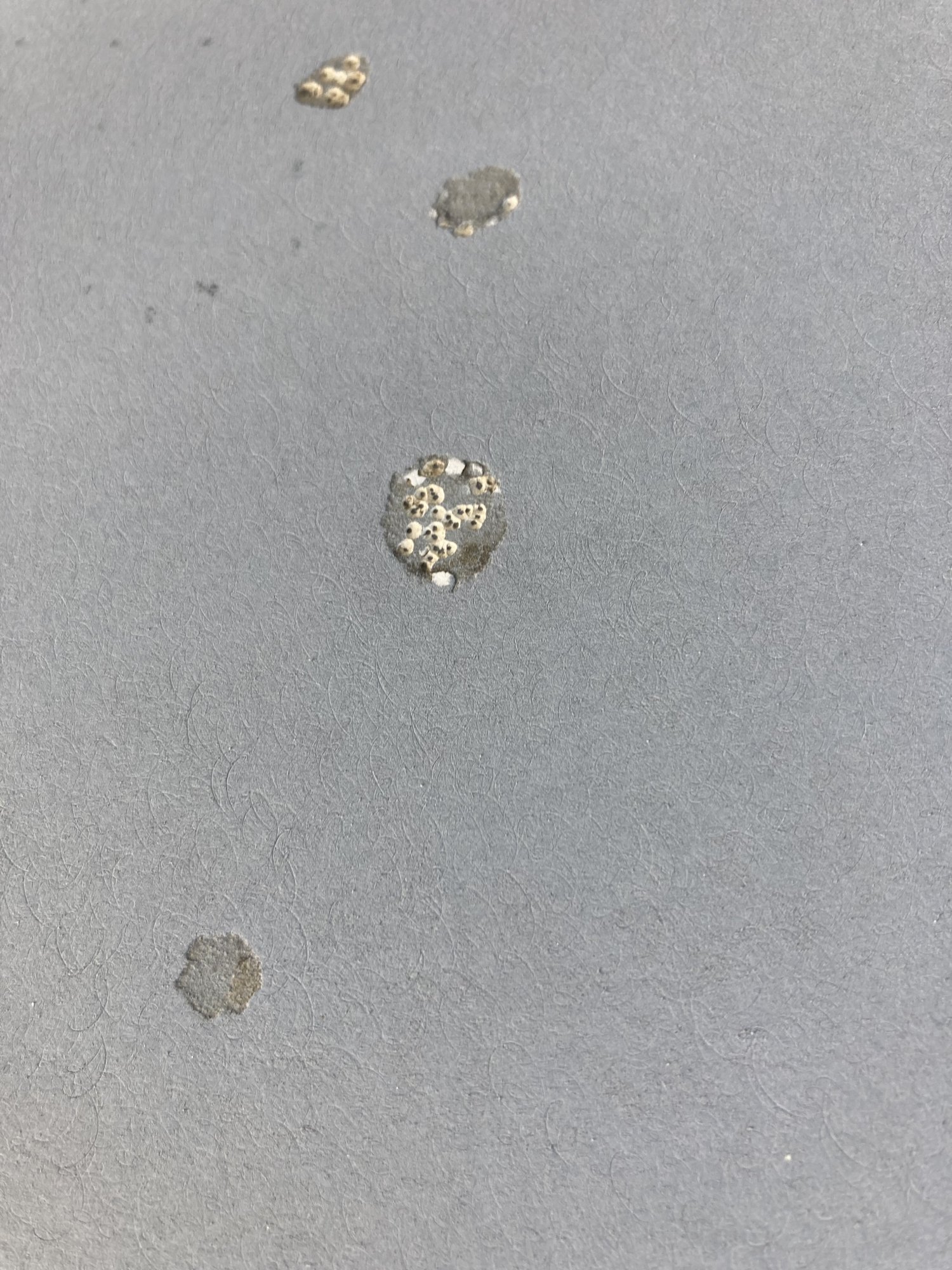

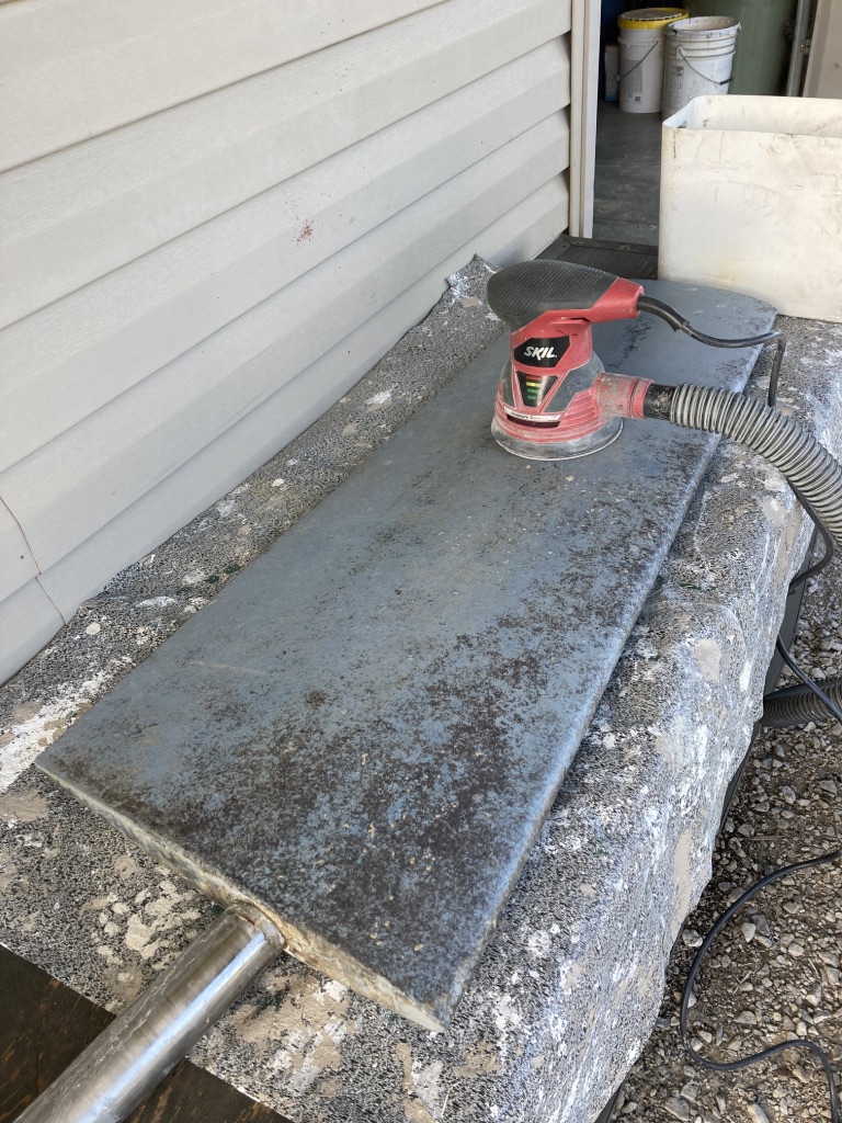

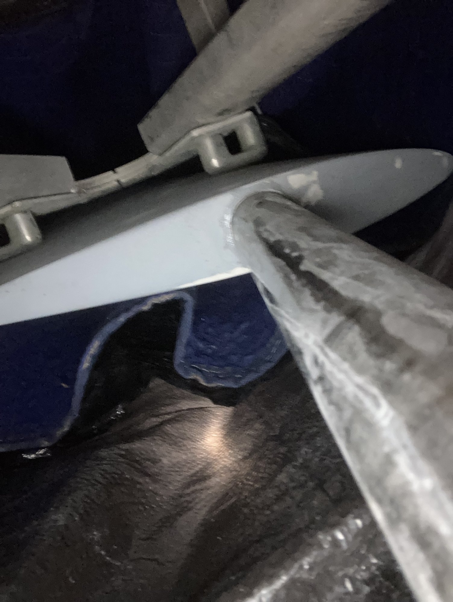

Before I first bought this boat, the first thing that I noticed was that the rudder skin had blisters that my sailing buddies said I would definitely need to have restored. I took it to a body shop that does extensive work on boats, including sailboats. It took them a few weeks of cautious heat and forced air to dry it out, then fortified the skin.
I, being a painter by trade, applied several coats of Interlux epoxy primer to top off the repair. when I hauled her out a few months ago, the blisters had returned, and the only apparent point of water entering the core was where the tube enters the top of the rudder. The primer had released from the stainless tube, and it was obvious to me that this was the initial point of failure.
Below, is what a semi-retired lifelong "Mr. Gadget", who finds his shop his "happy place" during the winter, with sailing KY Lake his "happy place during the summer:

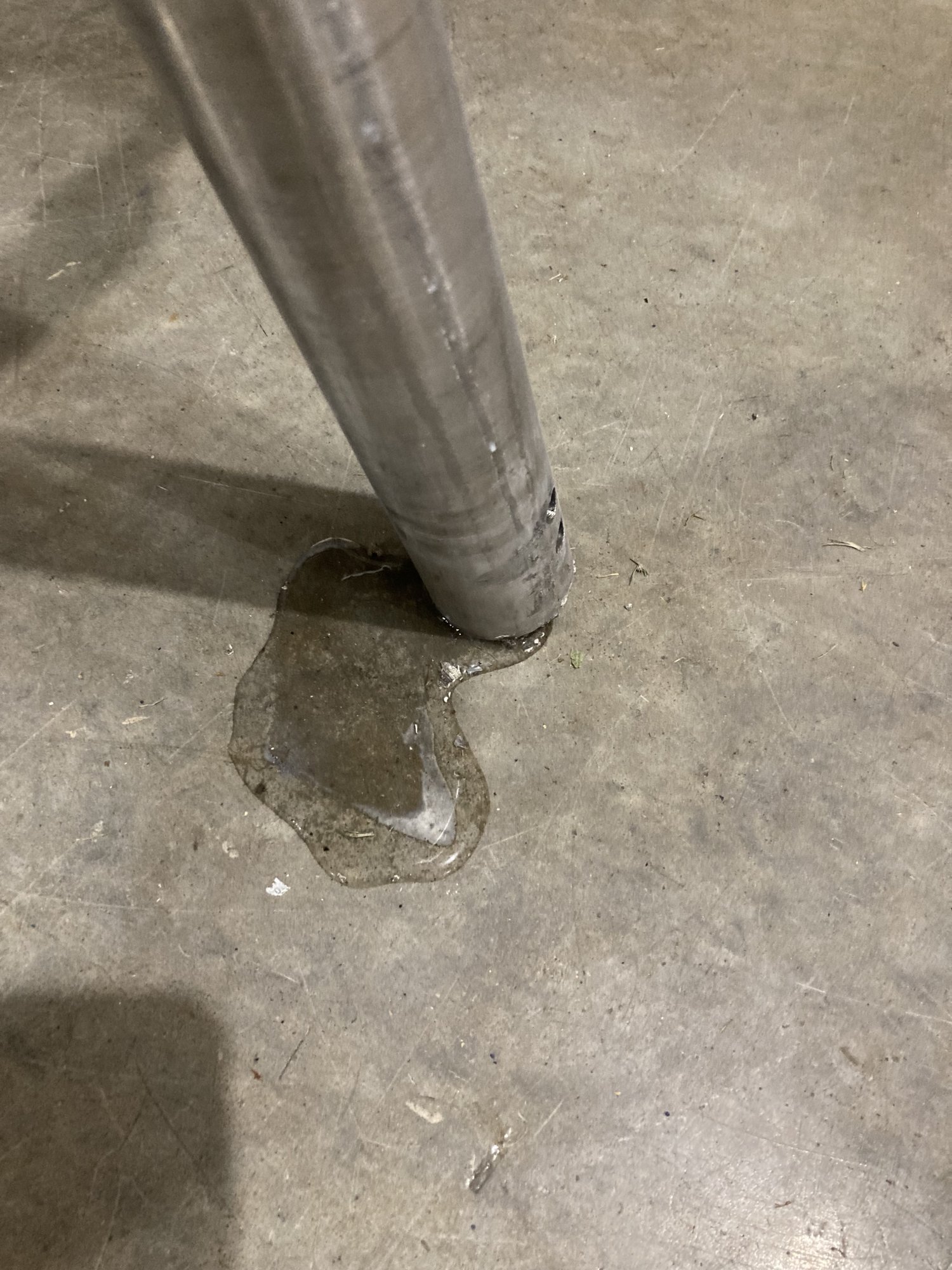

The first thing I did after removing the rudder was to stand it on its tube, upside down, and water began to drain from that point, and run down the tube onto the floor. I then stood it upside down on a board, and secured it to a post where the rudder would face South. The hot sun would heat it up in the daytime creating pressure inside, and the water drained would increase. The cool night temperatures would create negative pressure, allowing for the heat of the sun to daily pressurize the interior, and continue the draining.
Unless you guys have better ideas, or cautions, I will now drill a hole in the rudder bottom surface, insert a compressed air fitting, and begin to apply gentle air pressure from a small "pancake" compressor which has an inline moisture separator, and a pressure regulator. I will adjust the pressure carefully, and begin to circulate dry air through the rudder and that air will exhaust from the tube into a catch pan on the floor. I will also carefully place a heat lamp that will aid the process of pushing wet air down through the tube. I will monitor the water level in the catch pan, which will be covered, reducing evaporation.
Before I begin all of that, I will weigh the rudder, and monitor how the weight decreases to the point where the weight does not change over a month's time.

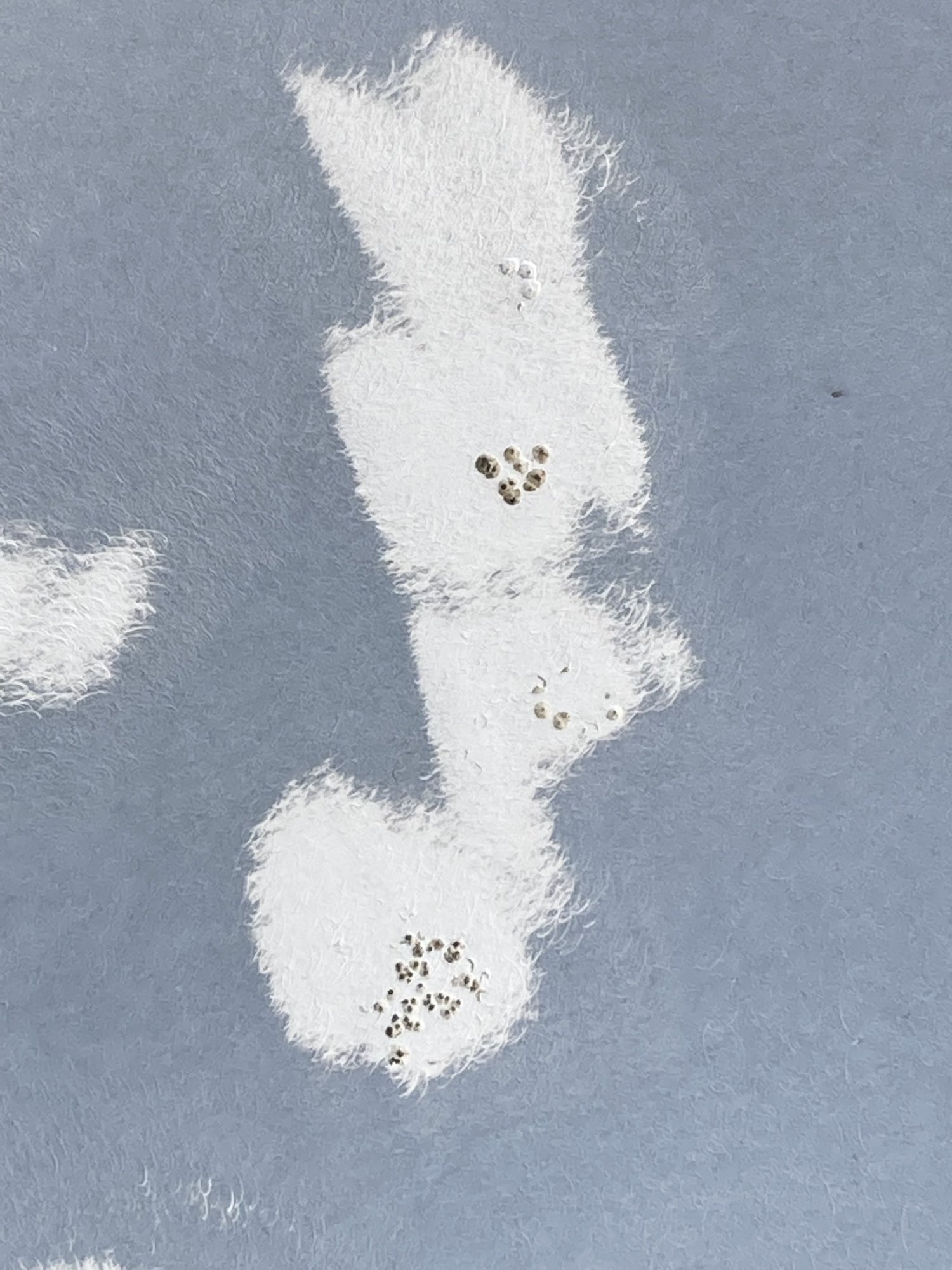

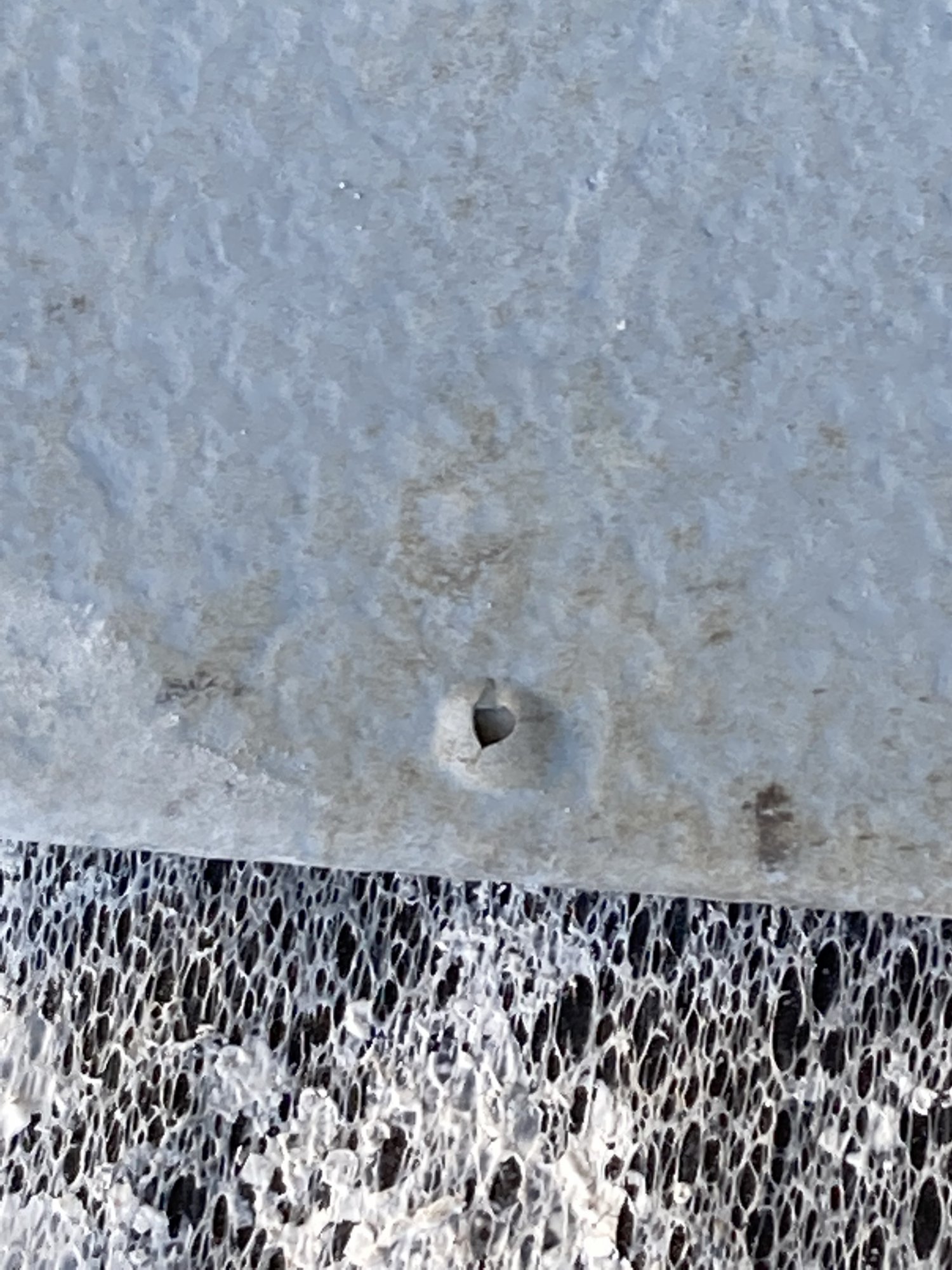

In the meantime, I will revisit the body shop to find out what material was the core, and update you guys. Maybe when I drill that hole in the bottom of the rudder, I will be able to determine what is the core material. Do any of the photos of the dried white residue give a hint to the core material?
Any responses will be greatly appreciated.

No need to guess at the core material or its condition. Drill a ¼" hole through the skin and into the core. The tailings will tell you what's in there and give a clue as to condition. Black mushy stuff is rotted wood. Tan powder probably foam. Sawdust, is obvious.
The hole can be filled with some thickened epoxy.
