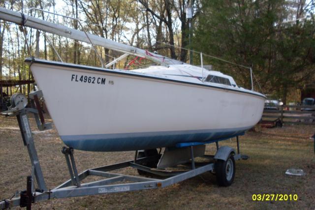

As for the trailer.. you may or may not be able to modify the one you have to fit the H23 depending on what you got. If it's the trailer for your previous 18 footer, it most likely will be too small. I don't have any decent pictures of the trailer by itself, but you can find lots and lots of pictures of H23's sitting on trailers if you do a quick Google search.. you can start out by looking at the pictures of H23's over at http://www.sailingtexas.com/cboats99hunter23.html (Sailing Texas web site). [warning: first picture in that list is actually a H22 :neutral: ]

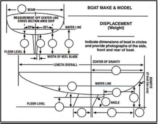

Had to build a trailer for our 26. Yours will rest on its keel but propped up by screw stands or bunks where mine, with its swing keel, fully rests on bunks. Here's a diagram to use in capturing some hull curves from your boat when it's stood up that you can then transfer to your trailer.
