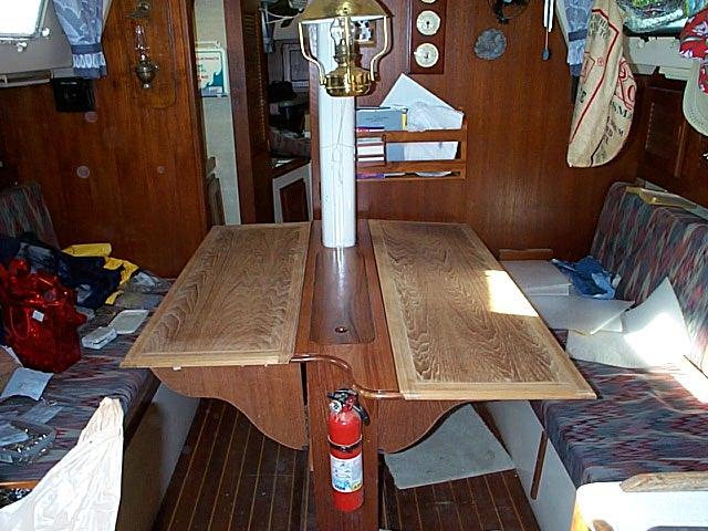

Well, the table leaves needed refinishing, and not wanting to tackle new veneeir, I chose to make new leaves..Got some 3/4 teak plywood, and some solid teak boards..Put a two inch band of solid teak around the plywood edges on all 4 sides with biscuts and glue.. Then milled the edges to match the original, as well as the drop leaf edge..Not too bad for a get engine mech..Still need to add the finish in this picture..
