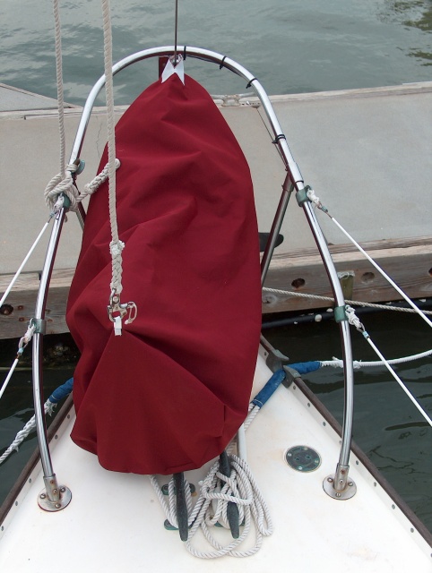

I've had five sails made from SailRite kits in the past. GOOD folks to deal with, and will discuss your needs and design a kit that does what YOU need. Jeff helped me a lot.
You'll love a jib bag. Just be sure it's big enough for your biggest normal sail. Don't make it JUST to fit the working jib for example.
Here's mine, from SailRite plans

Put a zipper along the length of top of that and it's MUCH easier to get the sail in and out of.
BTW, 3 strand for your halyard :eek: how do you control the sail shape with that rubber band?!?

That's a Dacron halyard, almost zero stretch. Fits the age and style of boat:) She is after all, 52 years old.
And the zipper on top is a good idea

I really didn't mean to change the course of this thread but the sail bag is somewhat confusing. I have questions about stowing and deploying the sail.
For instance, when you stow it, do you simply drop the sail on the deck, disconnect the sheets and stuff it in clew first and then on the forestay end, does the canvass wrap around the forestay and zip up or Velcro? Is be interested in seeing a view from the front.
You mentioned a zipper on the top, so you would unzip it, deal with whatever is going around the forestay, move your halyard and reconnect the sheets? I know how ignorant this must sound.
7,762
It's not ignorant at all - just new to you.
For ours, we didn't disconnect the sheets. We would drop and flake the jib, which would almost flake itself while being dropped. Then we would flake the sail forward towards the forestay in slabs of a little bit less than the length of the bag. When it was in a pile on the foredeck we would slide the bag over it. This is when it was good to not have such a tight fitting bag which is also true for a mainsail cover. I don't remember the zipper but I think it was forward of the forestay. It would probably have been easier to wrap the bag around the forestay and zip from the aft aspect of the forestay down the top of the bag. The sheets would double back and protrude from the bag. It takes longer to describe the process than to do it.

Mine wraps around the forestay and the two flaps are secured with Curtain Fasteners. I drop the sail, flake it, then slab fold it up in a pile on the foredeck. Unzip the top of the bag (it unzips completely from the forestay to the back where the D ring is), then slide it under the flaked and folded sail, pull it up around the forestay, then coil the sheets and drop them in the bag, and zip it closed. Then I take the halyard and clip it to the D ring and hoist the back of the bag a couple inches off deck. The bottom of my bag is mesh material so any moisture can easily drain out.
You could leave the sheets out, but keeping them clean and out of the elements seems more valuable then the few seconds it takes to run them each time you go out.
