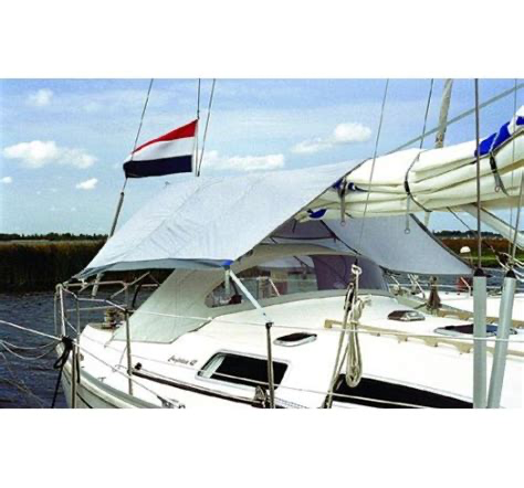

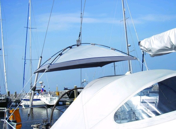

Fred, there is a cockpit sun shade or awning made by Blue Perfrormance
I found that Binnacle Marine was a good source.
Attaches to a main halyard and can be adjusted to meet the needs of crew when at anchor.

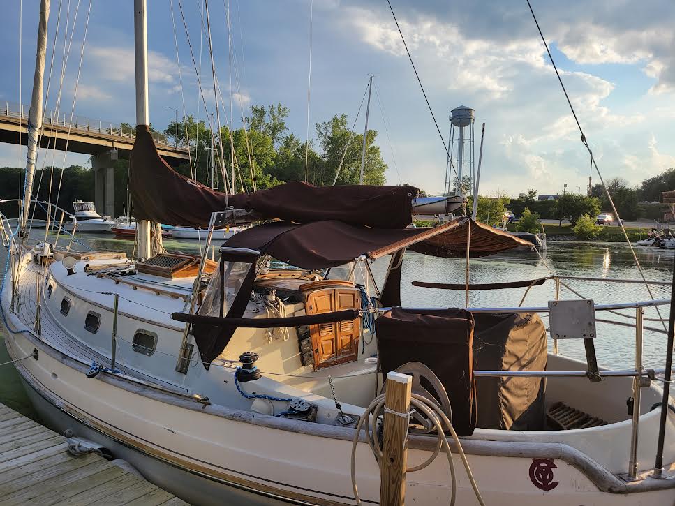

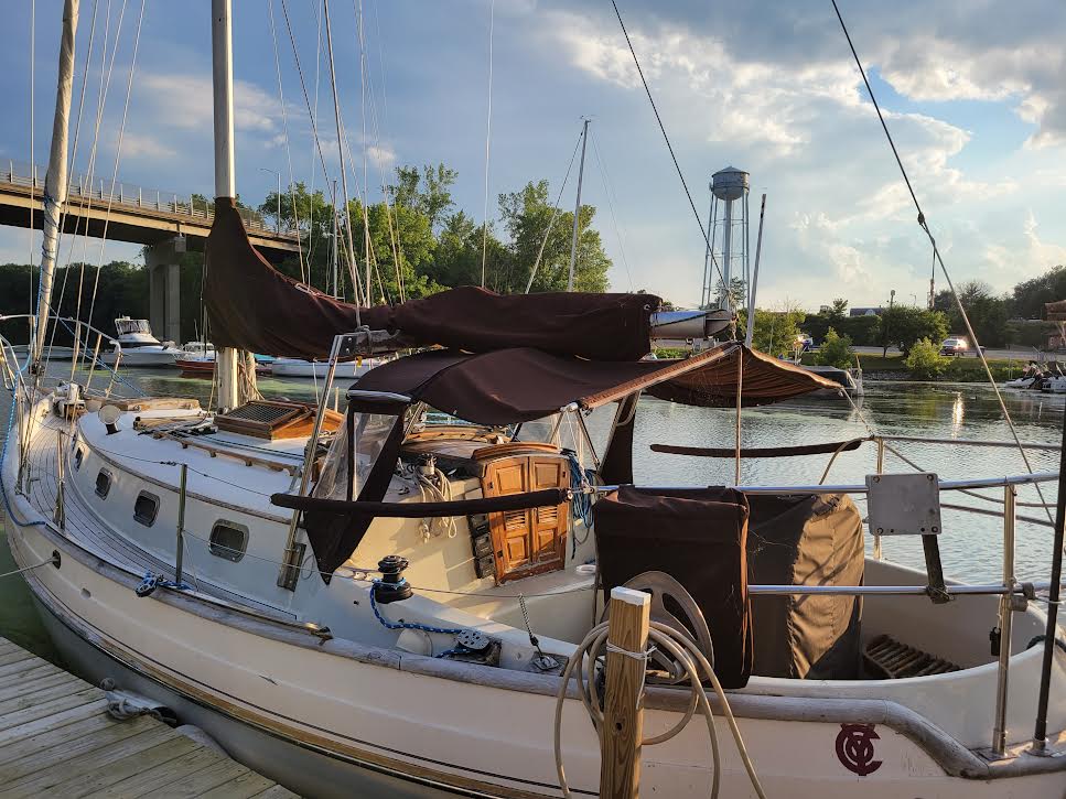

This is my awning. It zips into the dodger. The problem with it is I cannot use the mainsail when it is up. I am OK with that since most of my daysails are jib only. There is also an additional section that zips into the rear of the awning and is held up by the hook, seen in the photo, hanging from the back stay.
