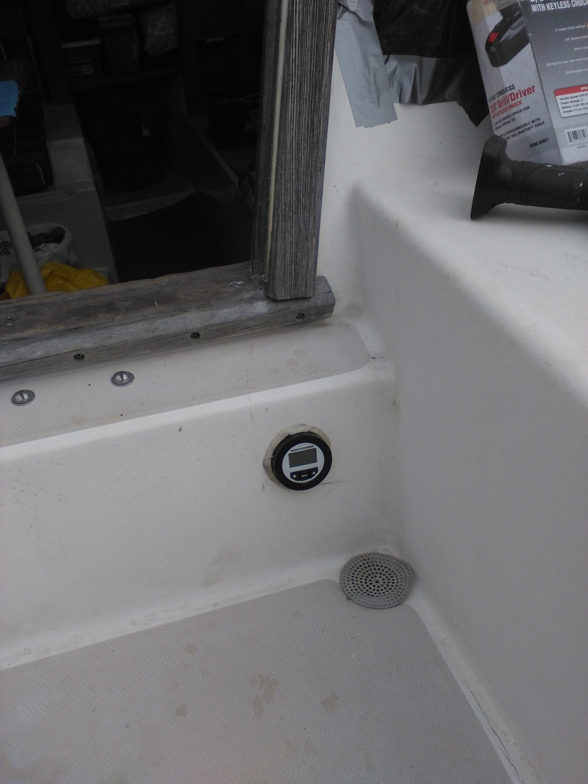

Just an update, finally got the real depthfinder installed and now no longer guess on depth when sailing or motoring
