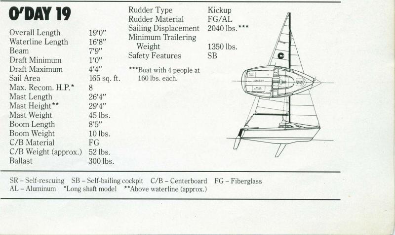

The 19 (not the Mariner) has that ballasted stub keel/centerboard combination. However, the stub on the 19 gives a reported board up draft of 12", whereas my 192 gives a board up draft of 18". Similarly, the Precision 18 has a minimum draft of 18". In his book "The New Trailer Sailor's Guide to the Precision 18", Tom Scott says that really the only time you need the centerboard down on the P18 is close hauled. All other points of sail can be sailed with the board up for less drag. In my experience, I can sail to windward in the 192 with the board up, but not effectively, as I get plenty of leeway. Looking at the 19, the stub keel has even less depth, though it could be longer fore and aft than my 192. Short answer: I would not expect the 19 to sail to windward without the centerboard down, but it could do well on other points of sail.

The keel of the O'Day 19 is not deep - about 4 inches. The O'Day 192 has a different design that houses the centerboard below the hull while the O'Day 19 houses the centerboard above the hull. The O'Day 19 has a very shallow draft but the O'Day 192 has a basic shoal keel when the centerboard is retracted. Different designs, different benefits and limitations. I like being able to beach my O'Day 19 when picking up passengers. I also have a Capri 22 with a wing keel. I can't beach that boat - need to wade and swim to it...
The centerboard on the O'Day 19 is made of plywood and is not weighted. I had mine out and lifted it myself. It is easy to remove and inspect.

The OEM centerboard on the O'DAY 19 is fiberglass, hollow and may or may not have a small amount of lead inside to make it negatively bouyant (ie: heavy enough to not float). CB is made from 2 molded halves bonded together with a resin slurry, pretty much all O'DAY centerboards (except Mariner and Javelin) were made this way.
