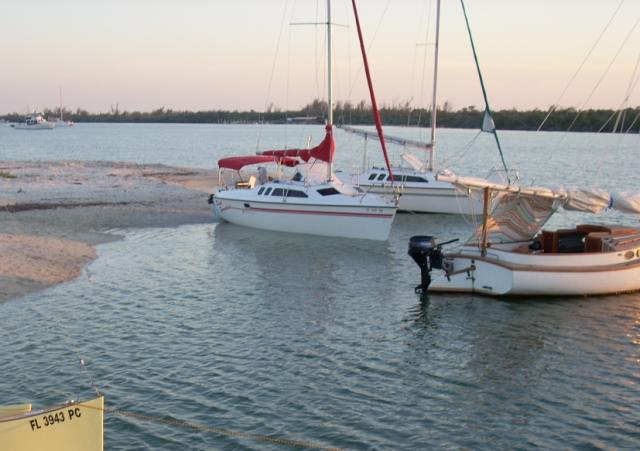

Perhaps my bimini is mounted lower than yours?
