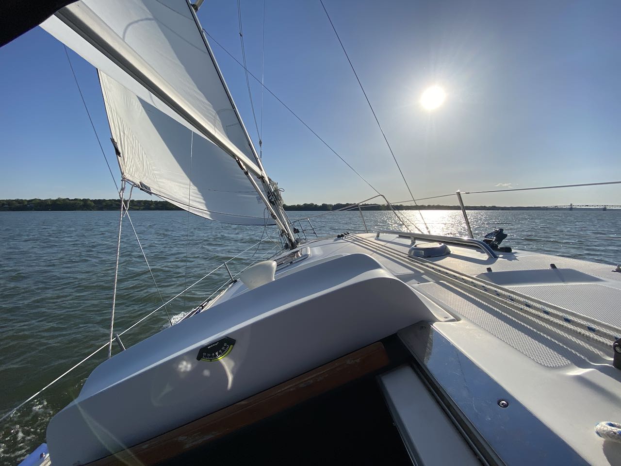

So far this has been a great start to the season. My 2005 H33 seems very happy to heel 22-25 degrees just as things start flying around in the salon. What do Hunter owners feel is a good heel without too much stress on the (fractional) rig?

In the OP the main looks pretty deep to me. Once you get to 15 Kts. the outhaul should be tight to reduce drag, and reduce power which translates to more heel and less speed. Racing boats get away with carrying too much sail because they can usually put beef on the rail to flatten the boat. If Brian D didn't make it clear, the rudder is a brake in the condition of excess heel. "Let de bot walk, mon..."
