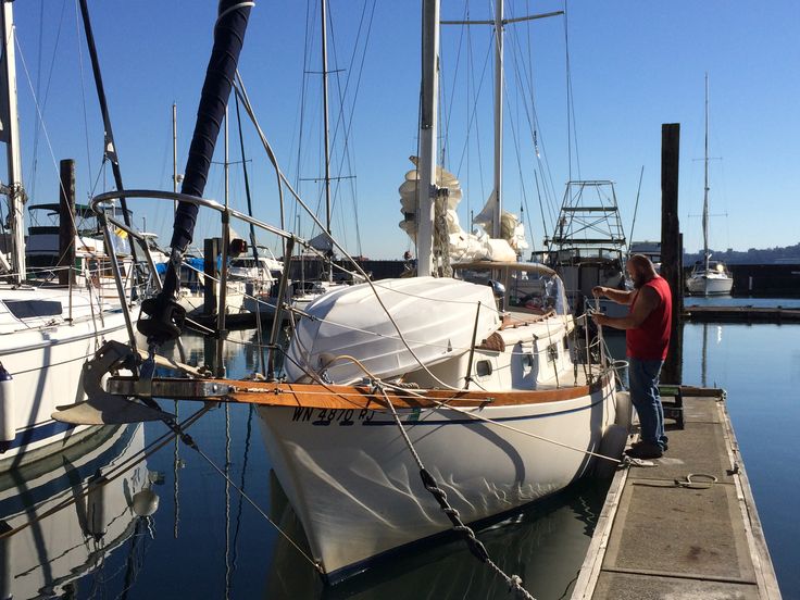

Not sure but this could be a Walker or equivalent in the following photos. They show a tender stored on the foredeck.
