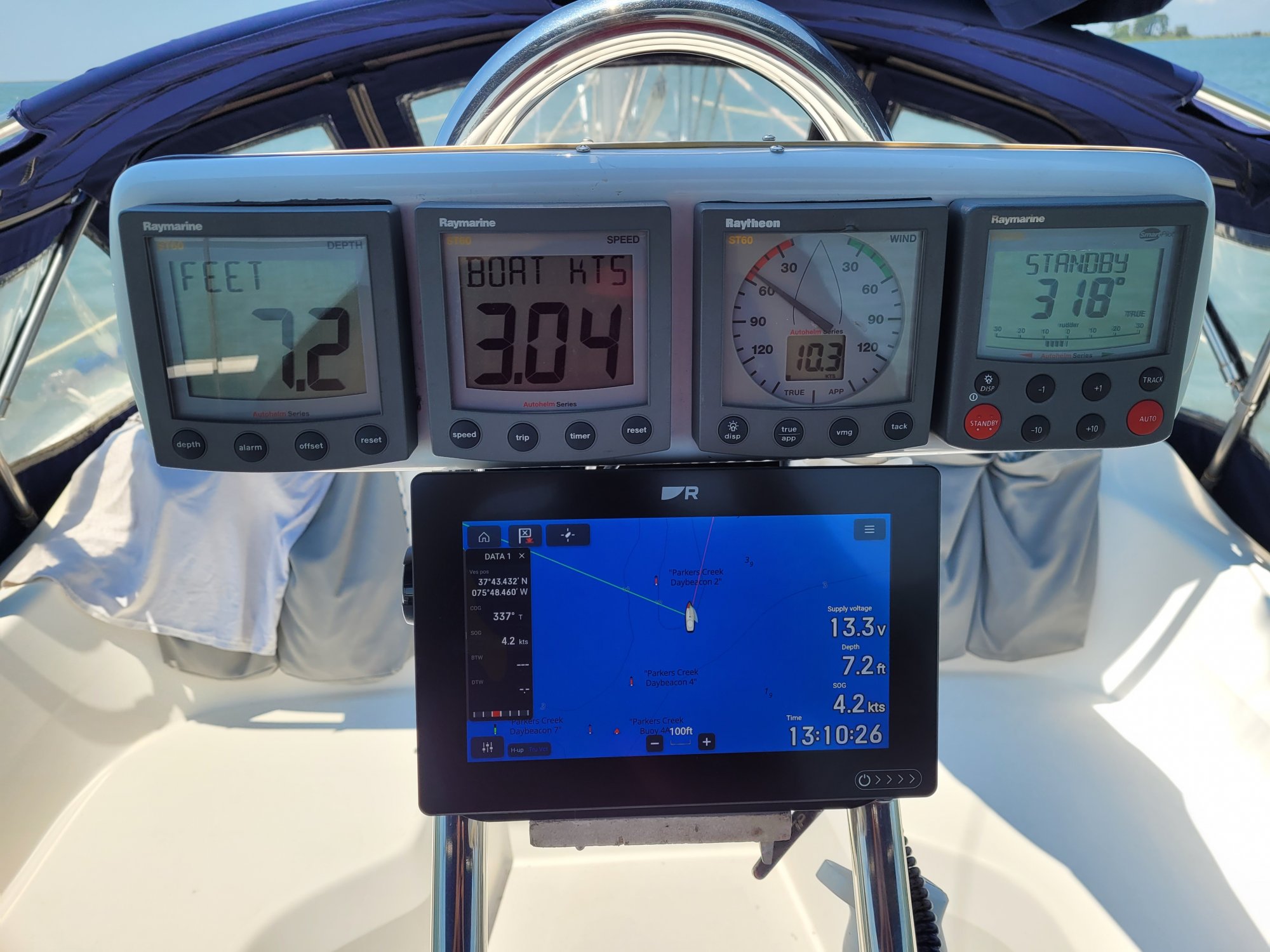

I feel pretty fortunate as my ST60 instruments are still working great and are now integrated with my new Axiom+ chartplotter. Last year I helped a friend replace all his ST-60 instrument with the i70 series and they are nice. The best thing is they all have Raymarine's SeaTalkNG interface in them so since there was limited space in the tube for wires we used the ITC-5 converter to put all the Depth, Speed and Wind data onto the SeaTalkNG network so he could see it up on the helm. On my current setup I went with a Standard Horizon 2410 AIS VHF radio that has the NMEA2000 connection, but everything talks seamlessly. In fact the Axiom+ has an NMEA2000 connection and Raymarine supplies a NMEA2000 to SeaTalkNG adapter to talk the the SeatalkNG/SeaTalk1 network. The only difference between SeatalkNG and NMEA2000 is the size and format of the connectors. I personally like the SeaTalkNG better as the connectors are an RCH smaller and easier to connect in small spaces. I have no experience with B&G, but for the MFD it was a shootout between the Raymarine and the Garmin 943xsv with me choosing the Raymarine as it just seemed a little more user friendly. For the durability, I think it is hard to be the Raymarine instruments.
