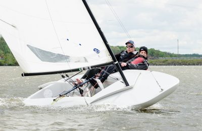

Is this the boat? MC Scow. A Melges-designed performance OD?
If so, I imagine the crew "works" the traveler (as Don confirmed). Down in gusts and up in lulls, at least going to weather and probably on other points as well. The crew works the traveler for the best angle of heel for performance. Crew weight and position probably affects where to "set" the traveler to optimize the angle of heel.
That attached photo is a C scow. usual crew is two. MC is smaller at 16 feet and is single handed except in breezier conditions. As I recall the MC hull weight is about 420 pounds, its cat rigged and sail area I believe is about 135 square feet. Its been a few years since I have sailed one.
Generally, the traveller is dropped a few inches to keep the boat heeled at more like 15 degrees, 30 sounds a bit extreme, that would just about have the rudder out of the water.
The boat has leeboards and generally the windward board is retracted. On a reach, the leeward board is often retracted about halfway or so. Its a planing hull and will go like mad in the right conditions. They are a blast to sail.
I was always a bit heavy to sail one competetively except in windy conditions When I was sailing them, I owned MC822, MC1236, and MC1465 in succession. I sailed in a club that at one time counted 45 boats in that fleet and routinely fielded over 20 boats on Saturday and Sunday races.
