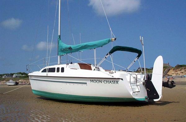

I want to add to Hugh's comments..........I moor my H23.5 in Cape Cod Bay, Ma. Tides rise to 12 feet at that mooring and when the tide goes out (low tide) the boat sits on soft sand. I have been mooring this way for the past 10 years. My board became detached from the boat because of the following :The conclusion of how the centerboard came off the boat is that the control line (uphaul/downhaul) broke about three inches from where it attaches to the centerboard. The board fell vertical and the tide went out driving the board into the sand below the boat and the wave action and the weight of the boat wallowed out the bushing in the board which holds the pivot pin in place. It did not take long for the board to detach under that strain. I had been concerned about the weight of the boat on the hull possibly causing damage to the hull or board but was advised by Hunter that the boat was designed to allow it to be beached. Here is a photo of the boat on the sand at low tide.

Mike how u get to your. Boat to go sailing. Walk to it at low tide. Wait for high tide go sailing. Come back at high tide. Then wait for low tide and walk back to your car? No dingy necessary. Planning your sailing must be a challenge. I'll bet the price of the morring Is cheap.

I don't want to hijack Tom's thread, but I am interested to know whether Mike would leave his ballast drain valve open to minimize the weight on the CB structure when the boat dries out at low tide?

Draining the ballast seems like a good idea but when it fills back up what about sand getting in?

I keep the ballast control closed to prevent sand and sea creatures from getting into the ballast compartment. When the tide comes in the ballast fills as the gasket on these 23.5's is not 100% tight and when the tide goes out the water drains back out.
To answer "teebutch's" question, I often walk out to the mooring when the tide is coming in and the water at the boat is knee deep, and sail away.
