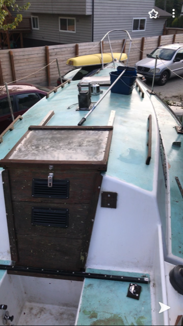

Hello - I'm looking for some words of wisdom when it comes to repainting the deck of my 27' sailboat. Its in really poor shape so I'm working on removing deck hardware, winches, railings right now to prep for sanding. It used to have an Interlux Brightside paint that was called Holiday Green - mix of light blue and light green and white (see photo). I've been looking at the Interlux color charts and I feel like it would look neat with Ocean Blue w/nonslip mixed in and regular white on the deck. Body is white. I'm not sure if going with a dark color would be good though - I live in PNW so its not particularly hot but I've rarely seen examples of people painting their deck a dark color, typically its white or light colors. Would it look weird or something? Any reasons for other than temp?
I'll be refinishing all the teak wood, faded windows and hatch plexiglass too. Thanks for any suggestions!
