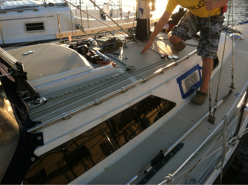

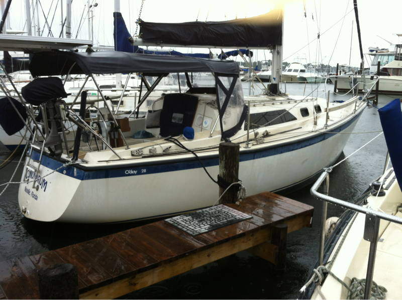

I have a harken traveler on top of the salon now. That permits me to have a full Bimini and dodger and uninstructed access to the cabin. The po has and adjuster on the split back stay but I never use it. I have two lewmar 16 self tailing winches on top of the salon and two barycenter 26 two speed self tailing winches on each side of the cockpit. I replaced all the deck organizers with triple garhaur. Deck organizers and the lines turn st about 45 degrees from the mast. Everything works pretty well. Probably the best thing I did was replace the masthead sheaves and pins

I would love to see photos of your setup. We are planning to sail as is for this year, but I'm aiming for a setup just like yours by the sound of it. (You get about 2 months more sailing if you've got a dodger on Lake Michigan) Does the hatch cover slide beneath the traveler atop the salon?

Ill try and take some good pictures of my set up. Hatch does go under the traveller.
