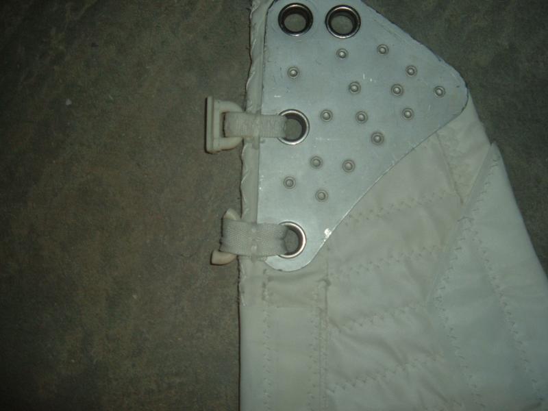

One of the two plastic sail slides at the head of my mainsail broke. Unlike the other slides that are attached to the sail with plastic shackles, the two at the top are attached via nylon webbing. I don't want to cut the webbing and re-sew it, and am looking for some type of sail slide - presumably metal - that could open up to attach to the webbing. I can't seem to find what I'm looking for online or in the West Marine catalog. Does anyone know of such a thing, or easy way to deal with this?
Attached pic probably explains the problem better than I can.

It seems that you really wouldn't needed to cut the webbing itself. Just cut the seizing, install the new slug and re seize. It shouldn't be a big project.

Exactly, a great time to work on your sail repair skills and gear. Get a regular slide like the one that broke. Start making a good sail repair kit with a large gauge sail needle, a palm, and some seizing/sailmaker thread. An easy fix.

That is why the top two slides are usually stainless steel slides.

The head slide(s) take much of the stress of raising, especially if you drift away from the wind a bit while hoisting, hence the usual installation of steel slides. And they're flat slides, not slug slides.
If you don't want to buy sail repair gear, or worry about a repair you're not sure of, a sail loft can likely install them without much trouble or cost. If you use stainless slides, this will probably be the last time you'll need this type of work done.
Resist the temptation to use a shackle middleman, as it will cause issues with chafe and snagging. Not that you were thinking about it :) but I've seen others who have.

As the others mentioned.... a package of needles and some seizing line would get you on your way... Purchase a couple of extra slugs and keep them in your ditty bag with the needles, a palm, some seizing line, a sharp knife and some repair tape.... all this effort will make you feel quite accomplished and make you a more saltier yachtsman. Here's a link for supplies.... http://www.sailmakerssupply.com/prod_detail_list/23

this repair is easy
cut the sizing, unwind the webbing and insure tit is sound. if not go to JoAnn fabric and get some.
Using the old "folds" as a guide. Install the slide and weave/wrap the webbing into place.
Run one row of sizing where the old ones where near the sail and another near the slide.
The trick is to not use knots. Start out running the sizing in between the layers of webbing right along where you are going to do the sizing stitches with a tail sticking out. On the working end start your sizing making sure the 'tail" is captured by the sizing. and your stitches are tight. When you finish the sizing stitch run the sizing back through the webbing just like you started. that last bit does take a sewing palm if you did it right. Cut off the tails flush with the webbing.
repeat for the other sizing.
Should take about 10 minutes after you get the sail down.

A heavy nylon cable tie ("zip-tie") can be used to attach a new slide in a jiffy if you don't have time for a proper repair, e.g., while under way. However, this is just a temporary fix. The slide should be repaired properly at the first opportunity.

Once I lashed a couple--neatly--with about 6 turns of parachute cord while underway, just as an expedient. Lasted for years, until the next time I had the sail off and sewed it up properly. The only important difference is that webbing looks neater.
And yes, shackles are bad in terms of wear and breaking sail slides, IMHO.
