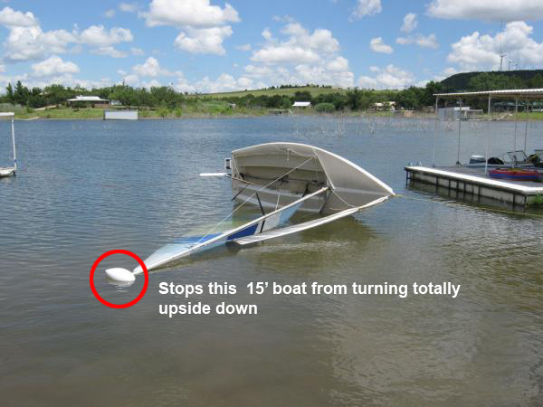

Re Mast Floatation have a look at this article by Tereza D.:
http://hunter.sailboatowners.com/in...id=267&cat_id=61&aid=7454&page=article&mn=146
A number of people, including myself have gone this route and have reported that it works fine. I also 'noodled' the back end of my boom. The front end should never be in the water if the top of your mast has mast floatation. I have attached a photo of a Catalina 14.2 that is using one of the Hobie Cat Baby Bob Mast floats that Hunter sells for their H146/15 and H170/18's. This is your alternative. I sold the one that came with my boat as I wanted a windex at the top of my masthead.
