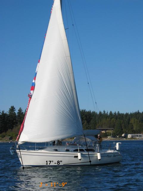

I measured the J dimension today on my foresail.
About 17'-8" .... 17'-10" it was a little windy.
My sail foresail bag has 135 stenciled on it.

I went to the boat Saturday, and measured again. "Decksweeping" is a misstatement, but it is nearly parallel to the lifelines all the way back (not as high cut as the picture on paulj's note). My genoa is 16'8" along the foot with some curve below the tape, and firm tension on the clew. For whatever reason, I measured luff and foot, but NOT the leach.
I am told I will probably have to take the sails off and have them measured during my club "handicapper's" assessment, but I think, based on fuzzy logic (my normal kind), 135 is probably still a good guess for the application.

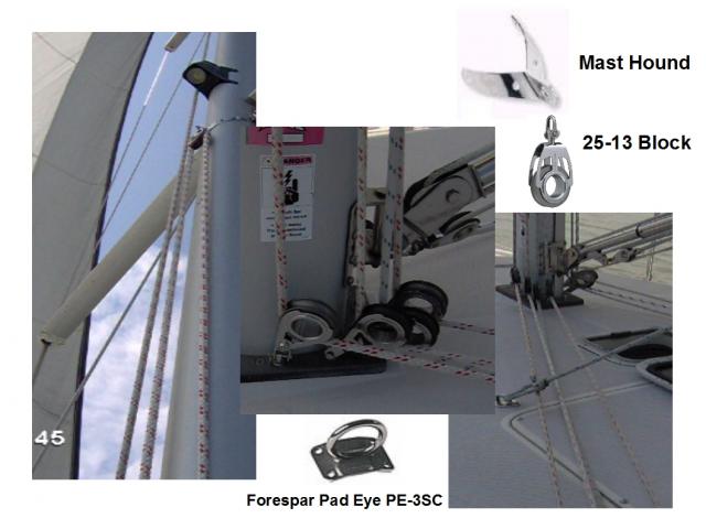

No spinnaker yet, but here is what I did
I have a spinnaker pole I made as well as a topping lift and a fixed ring. Went with the fixed ring as it looked like I had a wiring track riveted to the front of the mast and the fixed ring straddled the track. I am planning on going with a symmetric spinnaker eventually. Note that no one could tell me what height to put the ring so I put it eye level as I am 5'10' and it is about 5'8" and it is great. I store my pole on the port side using some Forespar stanchion mounts - keeps the deck clear.
