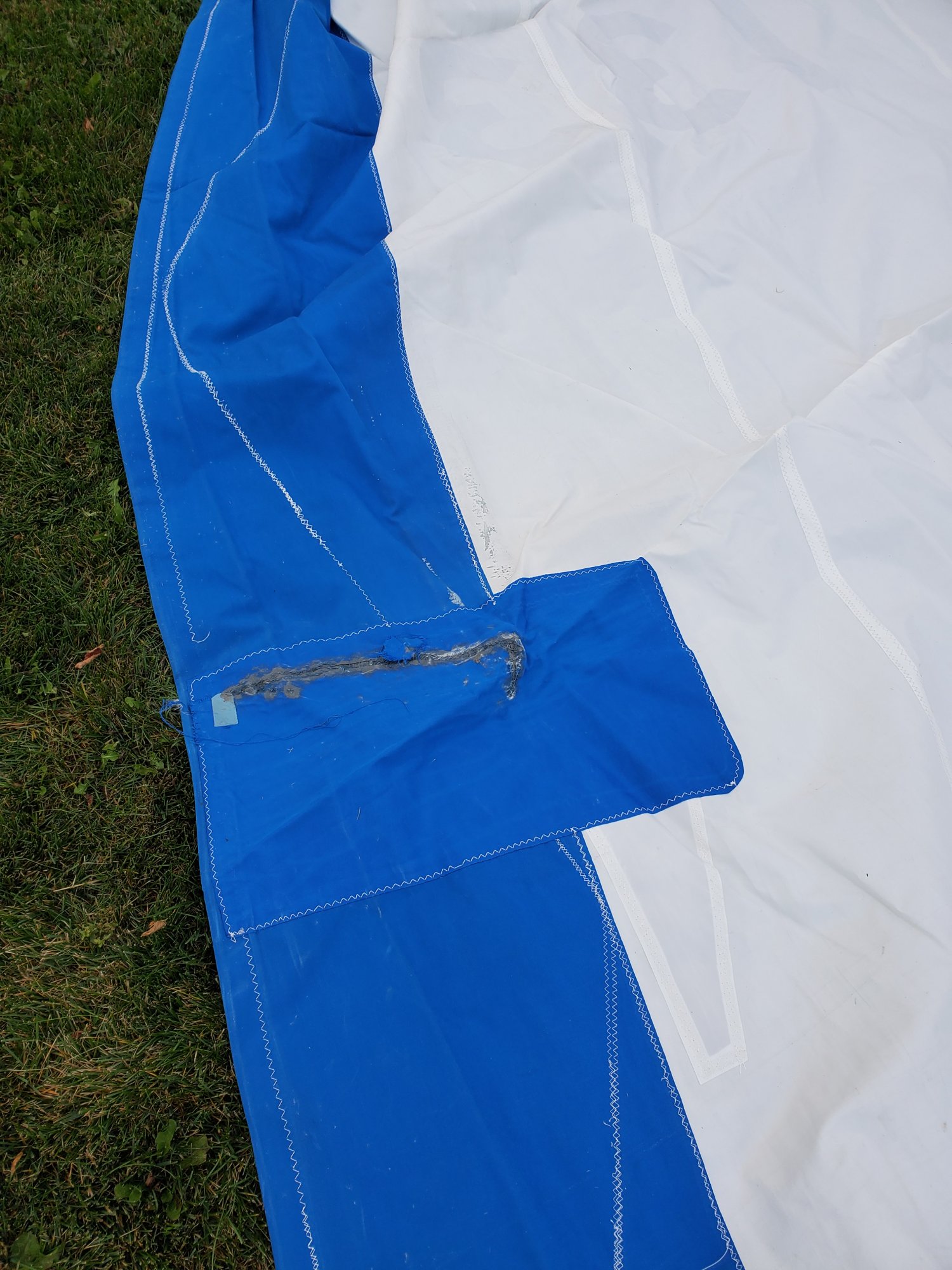

I have a genoa with a tear on the leach from contact with a spreader. This spot seems to have been repaired a couple times before by the previous owner. You can see the original patch here, the obvious blue rectangle but also a part of the sail cloth was patched. You can see it protruding down under the blue rectangle. This all seems to be professionally done. The more recent patch looks like the PO just glued it back together with what could be epoxy. It is stiff and not really appropriate for sail repair. I'll likely just cut out this area.
I have a friend with a SailRite machine that has repaired several sails so I can have this done very cost effectively and quickly. What material would be best for patching the leach of this sail and reinforcing it considering it will be in contact with the spreaders? I'm sure it's obvious but just in case it isn't, the sail cloth is Dacron.

My amateur response would be clean up the area and remove the hardened gunk. Remove the Sunbrella patch too. If things aren't too bad under the patch there are sail repair tapes. Put tape on both sides and stitch around the edges. Replace the Sunbrella with new Sunbrella in the area of the patch. For the other side of the patch, get a piece of self-adhesive sail cloth. This comes in larger pieces that can be used for spreader patches.
In the future, when it starts to wear, replace the spreader patches before they tear. Also you might try these on the shrouds.

As dlochner has already suggested. The repair would be pretty straight forward and I would use the same Sumbrella fabric.
The sail has been damaged at least twice, so my question is , Is it too big?
As a precaution in the future you could look at unfurling it only till it clears the spreader.

It may be too big. I haven't used it yet and the previous owner used the smaller headsail mostly. I will try it out and see next summer.

I’d suggest a kevlar laminate sailcloth over the patch. Tougher than anything else I know of, for that rip-prone spot. You might be able to beg a free remnant from a local sail loft.

I've seen people sew small pieces of soft leather on wear points ... I guess it is a similar strategy to what @Captain Larry-DH recommends. Kevlar would have the advantage of not needing to be oiled from time to time.

Don't forget to put some kind of boots on your spreaders for prevention

I do have vinyl boots over the spreader ends. I couldn't see anything the sail would tear on but I will have a closer look before putting the mast up in the spring. Those chafe protectors look like they would help.

My advice for repairing a dacron sail is this
Remove the sunbrella with the stiff glue. Inspect for damaged dacron. Patch as as needed with similar weight dacron on both sides. Used double sided sticky acrylic based seam tape to baste in place. Stitch the patch in place.

Replace the sunbrella with a piece that is the same width as the rest of the cover. Heat seal the edges of the patch. Baste in place with sticky tape and stitch.
Figure out what’s ripping the sail at the spreader and fix the problem by re wiring, removing cotter pins, taping, using a boot, etc.
If you want, install some sacrificial patches on both side of the leech. Clean the sail first. Use insignia Dacron with adhesive backing. The adhesive on insignia cloth is formulated to adhere to clean dacron well. Stitch the first layer if needed where it over lays the Sunbrella. Stick the second layer on without stitching. Inspect and Replace the top layer as needed, perhaps annually.
Sunbrella isn’t very abrasion or tear resistant, but most folks don’t need sacrificial wear patches on their Genoas. But if you need them because your technique does, then by all means, install them.
Here’s a link on how to place them spreader patches on a Genoa and install them
Don’t use epoxy to patch sails in an emergency. You can use 3m 5200 to glue a patch on if you cant install a patch properly. It’s flexible and will last for months. Mask/tape off the edge of the damaged area to keep the 5200 from being smeared everywhere. It can really make a mess, but it works well in a pinch.

Thanks Judy, the video is very helpful but also the idea to double up the spreader patch over the Sunbrella so the outer one is sacrificial. That sounds like the way to go.
