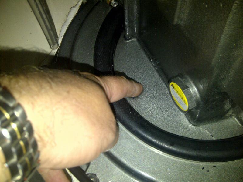

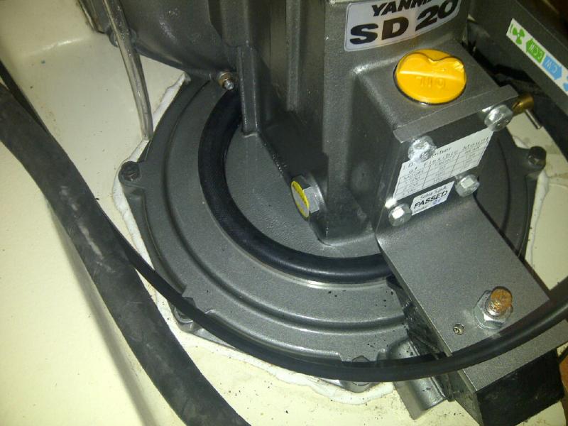

Last year we purchased a new Hunter 33. Through the sailing season we had no water in our bilge. After being proper winterized by the dealer, our boat went into the water 5 days ago.
Yesterday, we took the boat across Lake Ontario to our home port. We had to motor across due to the lack of wind. Just before leaving I noticed some water on top of the sail drive which I dried up with a cloth.
After our 5 hour trip, I noticed water again on the sail drive. See pictures.
Is this normal?

You need to check where the water is coming in. The yanmar sail drive I believe has two Seal's which would make it unlikely coming through the sail drive mechanism. Is there any hoses above that area that could drip water? Water on a sail drive is not normal.

Thanks NJsail. The dealer who also winterized the boat just emailed me and also believes is a nearby hose/hose clamp that needs to be tightened. (hose leading from the sail drive to water pump.
I will check tomorrow.

To get back to the problem...it turns out that the brass valve with the T-handle on the right side (you can just see it in second picture) was dripping. The dealer came by and we checked everything out. When the valve is completely open, all the way to the end stop, it does not leak, but if you close it by just one turn or more, it starts to leak.
5 days later and still dry.
We have decided to watch it and change it when the boat comes out of the water at the end of the season.
Anyone else have any issues with that valve?
