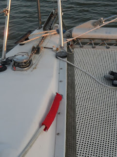

There is a bolt hanger hiding under the red webbing (there is a lashing in there too). No new hole required.

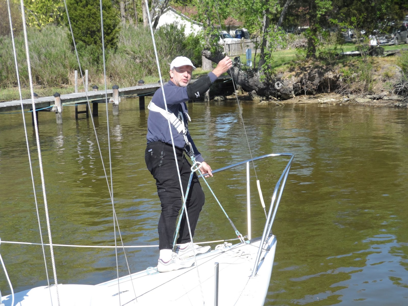

Pretty short, and I might go even shorter on this boat. I don't need to be standing, and I have a second, longer leg.
http://sail-delmarva.blogspot.com/2016/06/too-long-tethers.html
