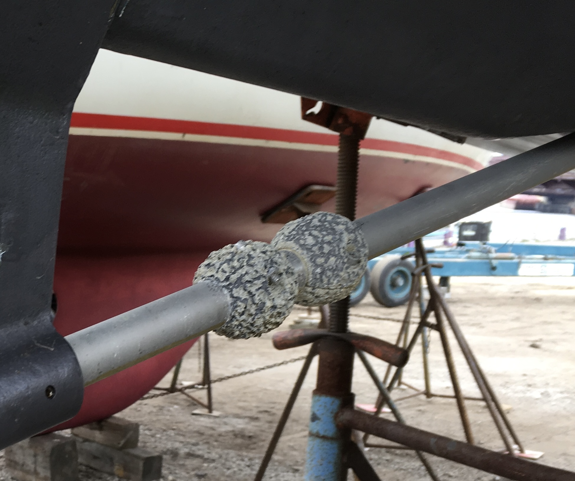

This old photo shows my prop shaft at autumn haul-out a few years ago. The left anode has seen two seasons and will be replaced before launch, while the right anode has seen one season and will be replaced after one more season. There is always one new anode on the shaft when the boat splashes in the spring.
You need at least one shaft anode to protect the prop. I doubled up on anodes because we went through a period of stray current activity (apparently resolved for now) in my harbor. I’ve just continued the practice because I’m not seeing any downside to it.
