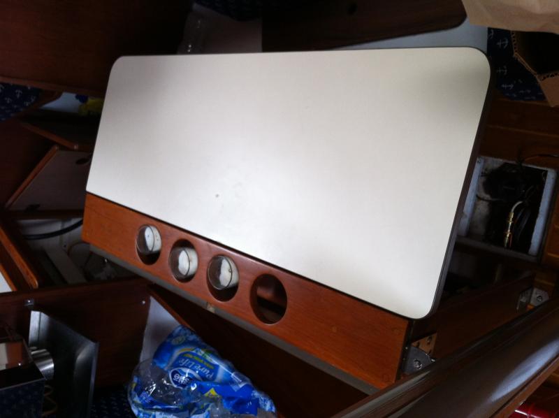

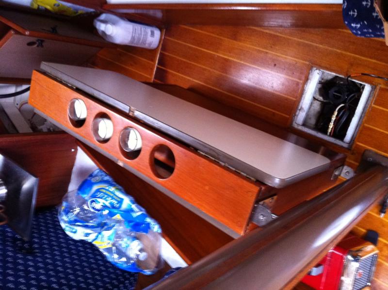

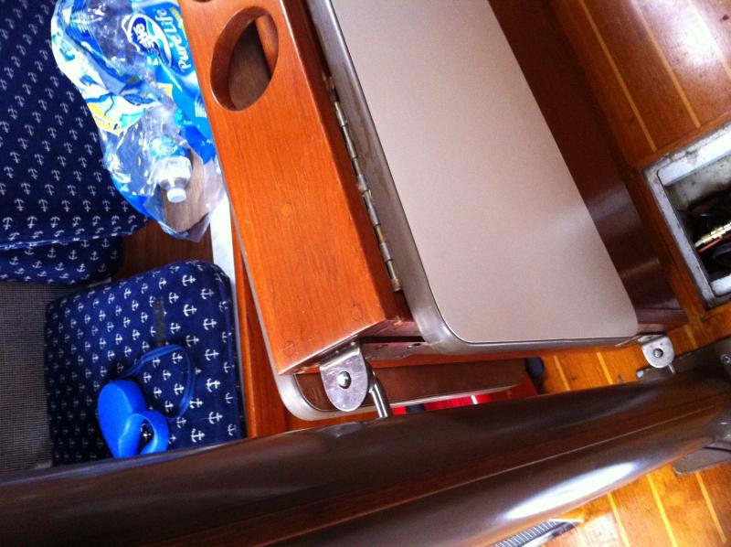

Purchased a 9.2 S2 in Oct 2009 that had no table at all. Now ready to build a replica table but need all dimensions of table and drawing of tabletop leaf supports. Would like suggestions for metal L brackets(? )which hold table to mast. Thanks, Jon B

a few table details...
The central support of the table is 30 in long and 4 1/8 wide
the flap is 31 1/8 long and the aft and wider end is 13.5 in at the forward end it is 11.5 in
the table is 28.5 in high...
missed the request for the details on the brackets and flap support...long week at work... will look later
