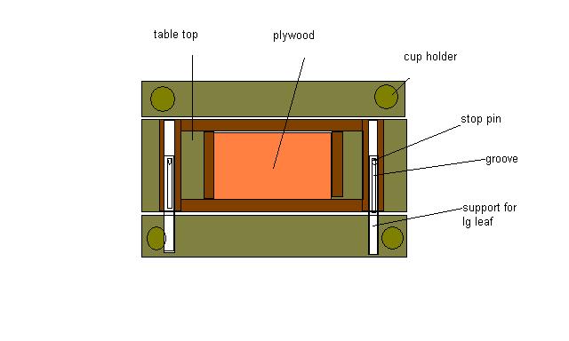

Here are the long awaited dimensions for the 9.2A table for the earlier models. I promise photos shortly. Hopefully these notes make sense along with the drawing of the bottom.
Table
Two Metal Legs 2.25 diameter that taper at top and bottom
Height of table with leaves closed 29 inches
Overall size 40” x 18” closed x 0.75” thick top
Three hinges each side for each leaf, one of mine is broken.
Large leaf 40” x 11.75” w pull out supports 1.25” x 0.75” X 18” extend out 6.5” from the table with a groove in top which a pin fits in to prevent them from falling out.
Small leaf 6” x 40”
Two three inch cupholder recesses with eigth inch brass trim and cork on each leaf.
Top sits on a 27” x 10 sheet” of half inch plywood with a teak “L” framing around it. Side L framing extend 5.5 inches at stern and 2 inches at bow with 18 inch u channels in the longitudinal boards for the top supports. Boards with the U are 1 5/8” by 2.5” wide. Lock pin is about 10.5 in and U channel is 1 1/8” tall x 7/8”. Lock groove is 7 in but mine chipped out at the far end, so I suggest you leave more material.
Legs fit into metal cones with a hole that are surface mounted. They engage the tapered leg about 2 in.
Ladder clearance is only six so suggest a smaller table for you. Two inches further forward too. Aft leg is eleven from the seat wall and legs are 12.5 and 30 on center from there. Aft leg is 16” away and bow leg is 15.5” away from port settee.
