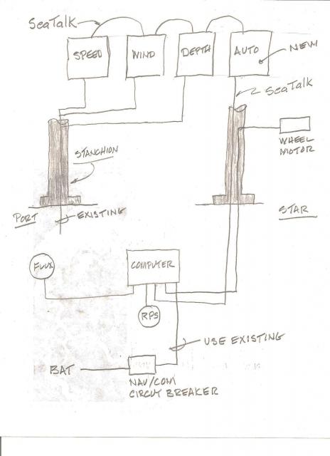

Looks good, the only thing is, and this would be unlikely to happen, conntect the wind directly to the AP that way if your depth goes out and your sailing close hauled on AP then it will still receive SeaTalk wind data.
