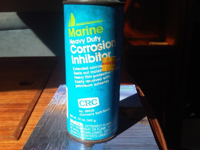

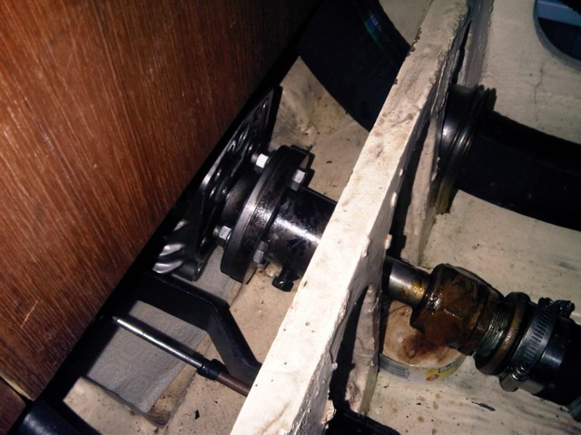

Remove as much rust as you can with a wire brush (they make small ones the size of a toothbrush). I keep a coat of: CRC No. 06026 Marine HD Corrosion Inhibitor on it. It hasn’t rusted for 5 years now. Another issue that helped me was to tighten up the stuffing box to keep a minimum amount of water splashing on it. The stuffing box/nuts are coated with wheel bearing grease. That keeps it from corroding and makes adjustment a breeze.
