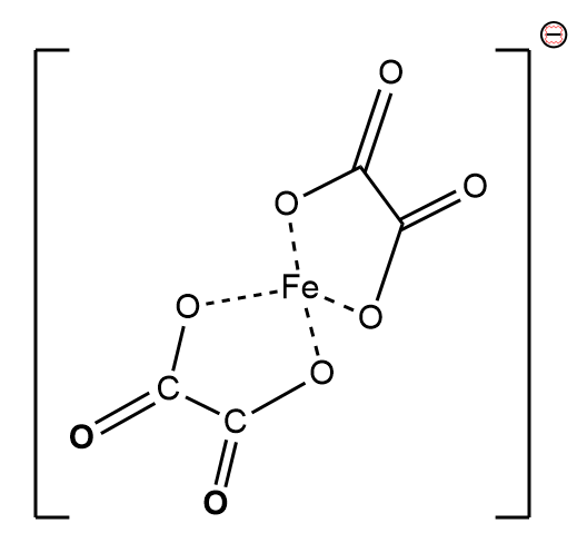

The formula of rust is Fe2O3 with a few associated water molecules. You often see the formula written as Fe2O3-xH2O. This is a neutral, water insoluble salt. The point you need to focus on is the fact that the iron atom is in a +3 ionic state (Fe+3).
Oxalyic acid is a dicarboxylic acid (structurally similar to vinegar -- yes your safety department was being ignorant) but oxyalic acid has two acidic groups per molecule. The red hydrogen atoms in this molecule are the "acidic" protons.
The two red protons can pop off in water and the resulting di-anion (oxalate) that looks like this....
... and two of these oxalate anions will bind to an iron+3 cation like this...
Groupings like this are called a chelation compound. (Chelate comes from the Greek verb "to cage"). The iron atom is trapped in a negative (-1) anionic group that is now water soluble and can be rinsed away with water.
Oxalic acid is also very good at destroying tannins which is the compound that gives leaves and wood their brown color. That mechanism is a little different and I'd have to get into the organic chemistry of conjugated pi-bonds to explain it but in short, oxalic acid should be part of every boat owner's cleaning arsenal. :thumbup:
