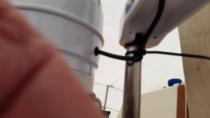

I'm with Maine on this as well. That pedestal is a busy place, that barely accommodates the compass wiring. A super pain in my opinion.
Here's a tip as well. If you do decide to run the wiring down the grab tubes, (which I urge you to consider), soap those wires up well. Even with a couple of wires already in the tube it will push through nicely. Without soap it can be frustrating bordering virtually impossible..

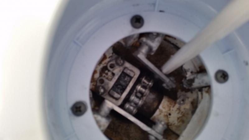

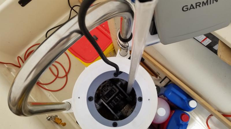

Go to any Home building place and buy 1 electrical sticking channel (tube) Plastic of course.. slide down the pedestal along outside of chain to find opening in center of the pulleys. once you do this now tie wrap to secure both ends.. Now slide your cables down the channel. even if the chain may rub once in a while.. your wires are safe! Note: I put mine down and the chain is 1/2 to 3/4 inches away from the chain. Hope this helps! Capt. Rob
