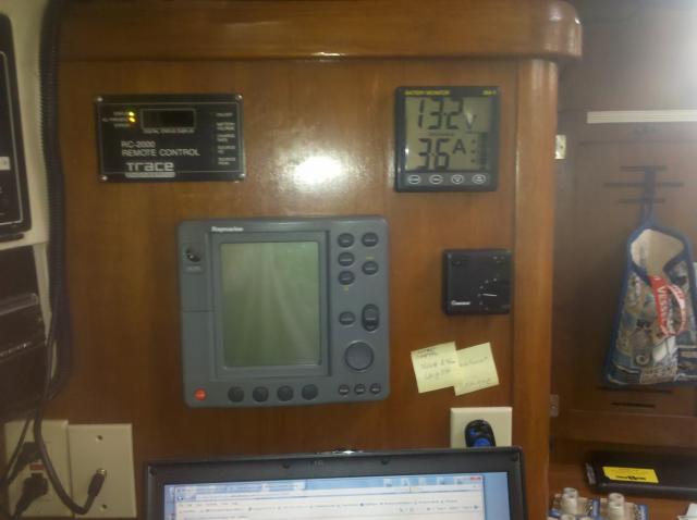

Well as I said I am not an expert but if you put the shunt upstream of your accessories that are drawing amps, it is not going to see any load and therefore will not read anything. I dont have a picture handy cause my boat is in another state. Yes it is true you will always loose accuracy depending on the length of the run but you are talking a 10th of an amp on most "recreational" boats because of the size.
Also I dont remember anything in the instructions specifically saying the shunt should be at the batteries but maybe someone will weigh in on that. All I know is mine reads accurately because I checked it against the spec of the things it reads ie, fridge etc. Also if you look in the pic, the trace digital remote is right next to the monitor. The two match exactly on battery voltage and they take their respective readings about 15 feet apart in the cable runs.
Ed what you said is exactly correct. The shunt MUST go to the battery negative cable. Mine does and it is at the negative bus right behind my dc panel. I suspect if you all take a look you will find all of your dc grounds going to a similar one right there at your dc panel.
