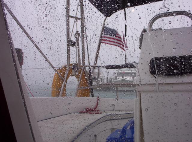

If you also install the radio in the console it is a simple matter. The cover on it is West Marine. 1st radio lasted 6 years and the CD player died and the current one is going on its third year. You can tap power from the courtesy light.
