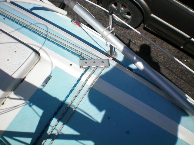

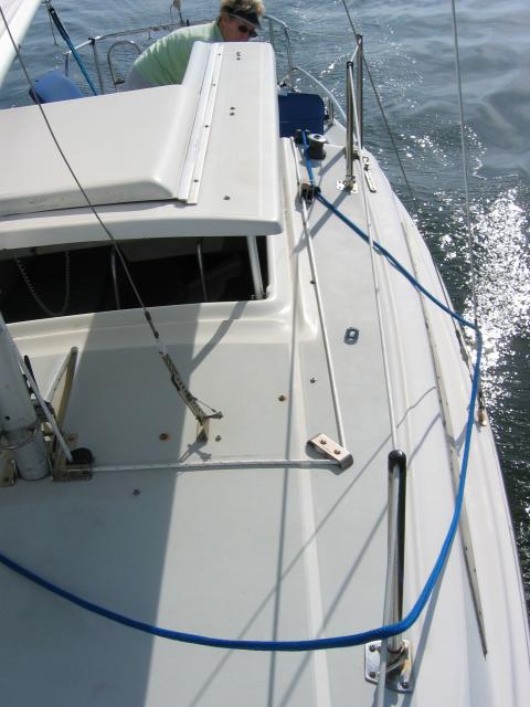

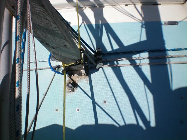

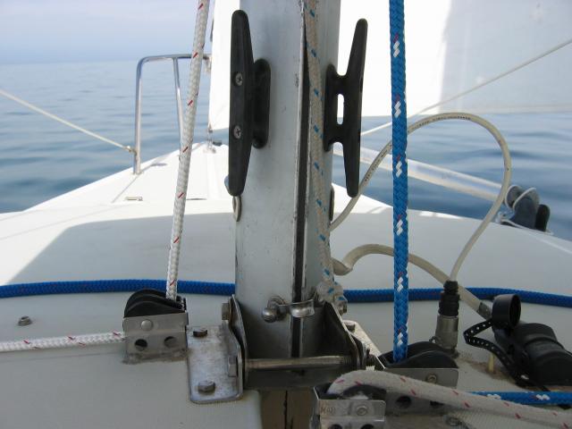

I have cheek blocks at the base of the mast, and a turning race way on port side going into 2 spinlocks.

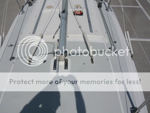

but they make a very nice deck plate you can attach blocks with shackles. that is the way to go. less drilling, more flexability. think it might be a dwyer....
anyone have the mast base plate with the multiple attachment points?
http://i64.photobucket.com/albums/h169/ftldiver2/MACGREGOR/P1000524.jpg
not mine but similar:
http://i64.photobucket.com/albums/h169/ftldiver2/MACGREGOR/picmacgregor26s102b.jpg
May 4, 2005
4,062
looks like Justin has the mast deck plate... I'd recommend using...

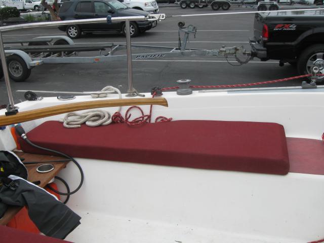

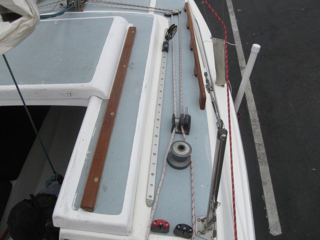

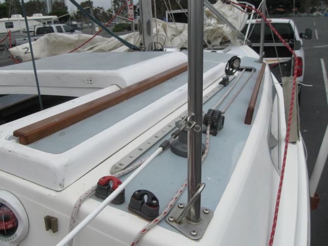

Imho, the only things that should have rope clutches are the halyards, and I went several years with camcleats with no problems. Only added the rope clutch and winch to make it easier to adjust main tension, that and I got the clutch for free. :D Some shots of my current setup from today. And one of the short cushions that clear the traveler.
May 4, 2005
4,062
agree, just the halyard need clutches. camcleats will take the load on the rest.
