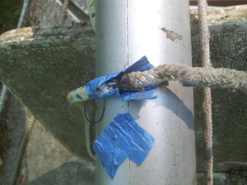

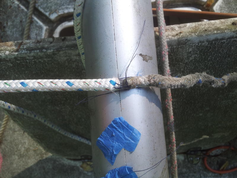

Attach a leader line to the old halyard. A line smaller than your halyard is attached to one end. You will need to remove any shackles you have attached to the halyard. What I do is use a line such as paracord and sew it to the old halyard with wiping twine. You need a smooth transition and it needs to be strong. Then pull the old halyard down through the mast. Attach the new halyard to the leader line in the same manor and pull it up through the mast. Detach the leader line and you have a new halyard in place. The mast being up or down is not relevant. Same process. Tape can be used to make a smoother transition between to two but don't rely on line alone.

If your old halyard is still there, what we did was cut off the old shackle, and use some Zip ties and Para cord to butt splice the new line to the old one. We needed to do it this way since our new halyard had the shackle factory spliced into one end of the line. Doing it this way allowed us to pull the new halyard from the top of the mast down though the blocks leaving the shackle splice intact.

Oh no, dude! You did mess up. When changing halyards I just sewed old to new and wrapped with some tape to make a smooth transition. This way there are no bulges to get stuck in pulleys and such.
