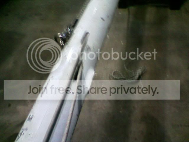

These look like plates for external mast blocks. Surely you want the blocks inside the mast! Obviously these plates can be drilled to accommodate internal blocks but a simple plate that fits inside the mast with turned down ears, for fixing, would be adequate and could be at any hieght, up the mast, that you require.
Beware, too many holes in the mast could weaken it.

Not sure how your going in on top
Then you will have to decide on some staggered exit locations
At some point they have turn which is were the mast plate comes in
All you need is hole in the mast that the halyard exits, maybe a foot or two off the deck depending on your angles. The halyard runs down along the mast for that couple feet and then through the blocks on the mast plate and are turned wherever you want them.
You can get halyard exit sheeves that mount in the mast and direct the halyards out, but you're less limited to the direction your halyards exit, and have to cut a bigger hole in your mast.
