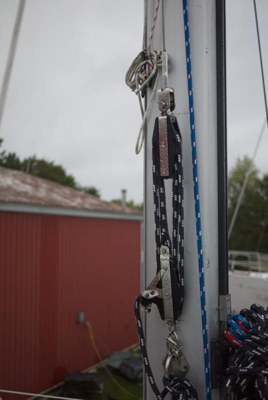

Sep 30, 2011
4
Beneteau First 405 Montreal
Taken from my First 405 1986, closest cousin of the First 38, based on the same hull in the 80's (90's First 38 is quite different)
