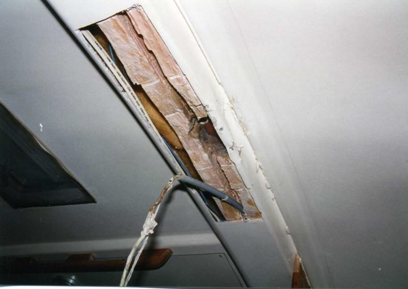

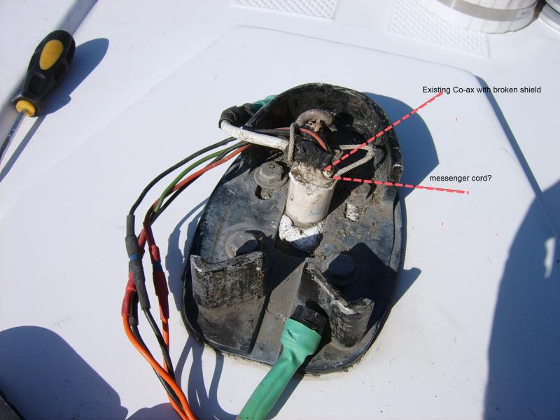

Latest job on the list- When I took the mast down this year, I found that the shield layer on my VHF cable is separated as a result of almost 30 years of being bent around when connecting/disconnecting when the mast is taken down or put up. That is why I was having intermittent problems with the radio in the last few months I guess.
I have attached a picture that shows the wires coming thru the caulk filled PVC thru the deck. The break is almost at the caulk. It means running a new cable from the radio to the connector. My questions:
1. is it possible to loosen the old cable in the caulk and pull a new cable back down from the top to save taking the teak covering off below etc.
2. The messenger line seems to be seized in the caulk- anyone been able to free it and where is the other end- in the "beam in the cabin top or down at the bottom of the post?
What is the routing of the coax in the cabin- thru the beam and over to the starboard side or down to the bottom of the post and under the sole?
I would be very thankful for any tips/advice etc from some one who has done this- Thanks in advance
