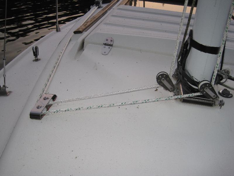

Hi Gordon, happy 4th! I ran down to the dock just now, and took some pics. They are in my album, but I've attached one here also. The H23 mast is mounted with two 3/8 inch stainless pins (not sure if the H25 is the same).
I cut some 3/8 stainless rod an inch or two longer so they stuck out far enough to attach the blocks on each side. I had to drill and cotter pin the rod, of course. If memory serves, I loosened the stays, and just tapped the new pins in. The rest is self explanatory from my album.
