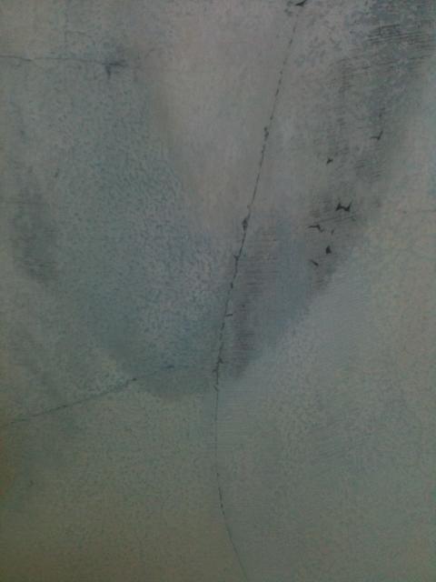

-My rudder has some surface cracks on one side.

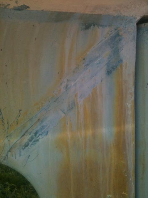

-The skeg has what appears to be a previous repair but it looks suspicious. Would the skeg have to be removed to replace the shaft if the engine remained in place?

If the rudder is not leaking when you haul the boat, it is probably OK. You could sand down the surface cracks to see just how deep the run and then make a patch with epoxy.
The skeg is bolted on and should be stable if you try to move it back and forth. There is a seam where it is joined to the hull but I don't think that water could get into the boat if the seam leaked or if the skeg came loose.
I had a mechanic remove my shaft and he did not have to take off the skeg but I'm not sure how he did it. There may be enough room if you take the shaft off the engine coupling and slide it out through the shaft log and prop strut. If that does not work, I have heard that it may be easier to loosen and raise the engine enough to slide the shaft out forward under the engine.

Your skeg looks like mine always has. (I bought mine new). I'd grind lightly on the crack to eliminate it, as water intrusion might cause permanent damage. There are numereous threads on what to use to fill in repair area to be found on this web site.

The rudder surface is likely cracked because of water intrusion which then froze during the winter. Once the core of these is wet, it is almost impossible to dry them out without a total rebuild. In the meantime, you can grind out the cracks using a 14:1 bevel then rebuild the surface using epoxy and fiberglass cloth or polyester and chopped mat with alternating layers of cloth. Fair with resin thickened with cabosil. Next fall, drill some deep holes from the bottom edge up and inspect for saturation. If you are lucky, a nearby boater may have a moisture meter and you can do your own rudder survey.

Gelcoat was very thick on hunter rudders, so the stress crack might just be gelcoat grazing. I would sand one of the crack down to see if the fiberglass underneat is cracked. You may start by drilling a hole under the rudder at the lowest point to see if thee's some trapped water.

Here is how your rudder was built by Foss Foam: http://newrudders.com/?page_id=12 . If you drill holes about three or four inches from the bottom you can drain the rudder. The foam holds the water because of the hard glass/gelcoat surrounding it. I used to drill mine every year at winter layup and then fill in the spring. The main entry point for water is where the glass goes around the shaft at the top.

Will be lightly grinding/ sanding area to check it out. Boat was not in water last year. I will drill to check and drain water in fall.
